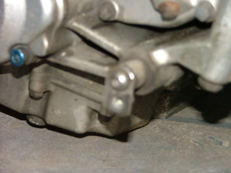

by phuk72 » Sun Feb 17, 2008 4:08 pm
BB
sorry it's taken so long
Here's a (crappy) picture of the extention - just a simple piece of metal, a couple of holoes drilled and a bit of threaded tube (or you could use a nut) tacked on. You should get the idea
And here's the belly pan
