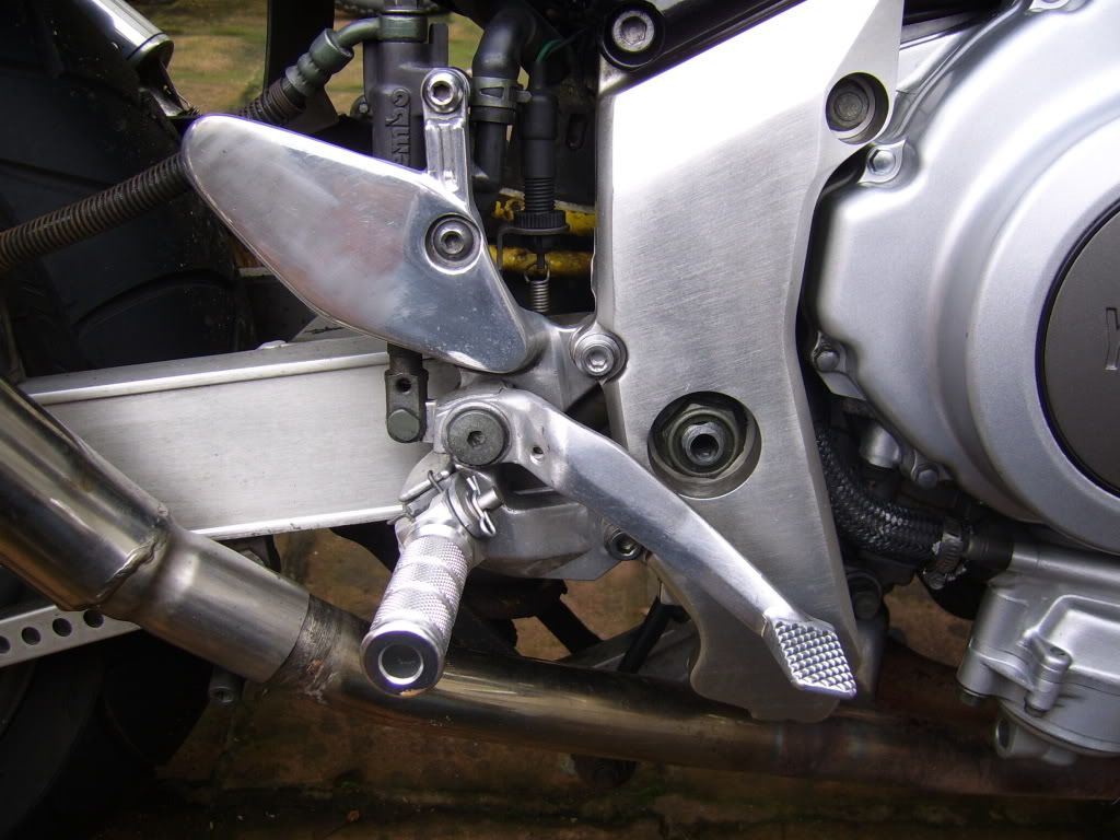

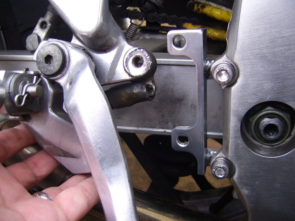

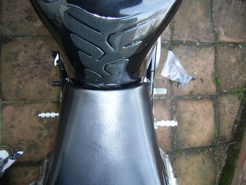

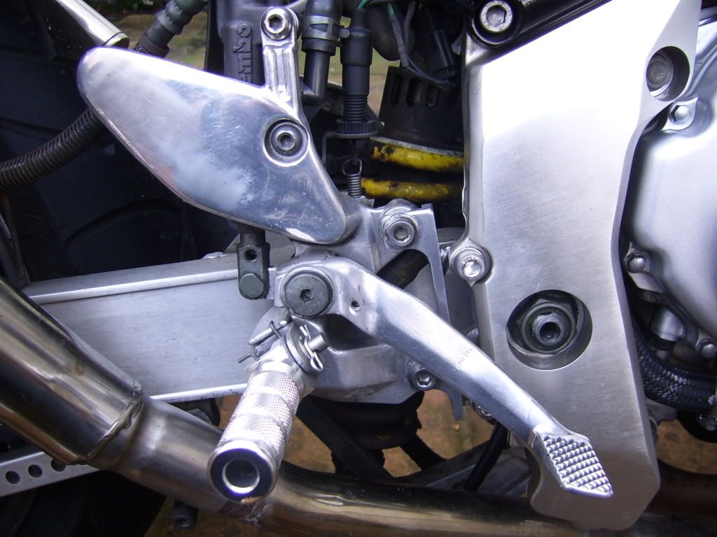

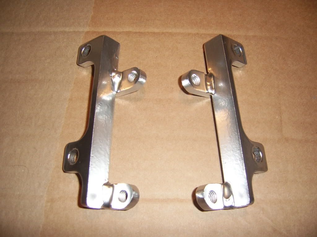

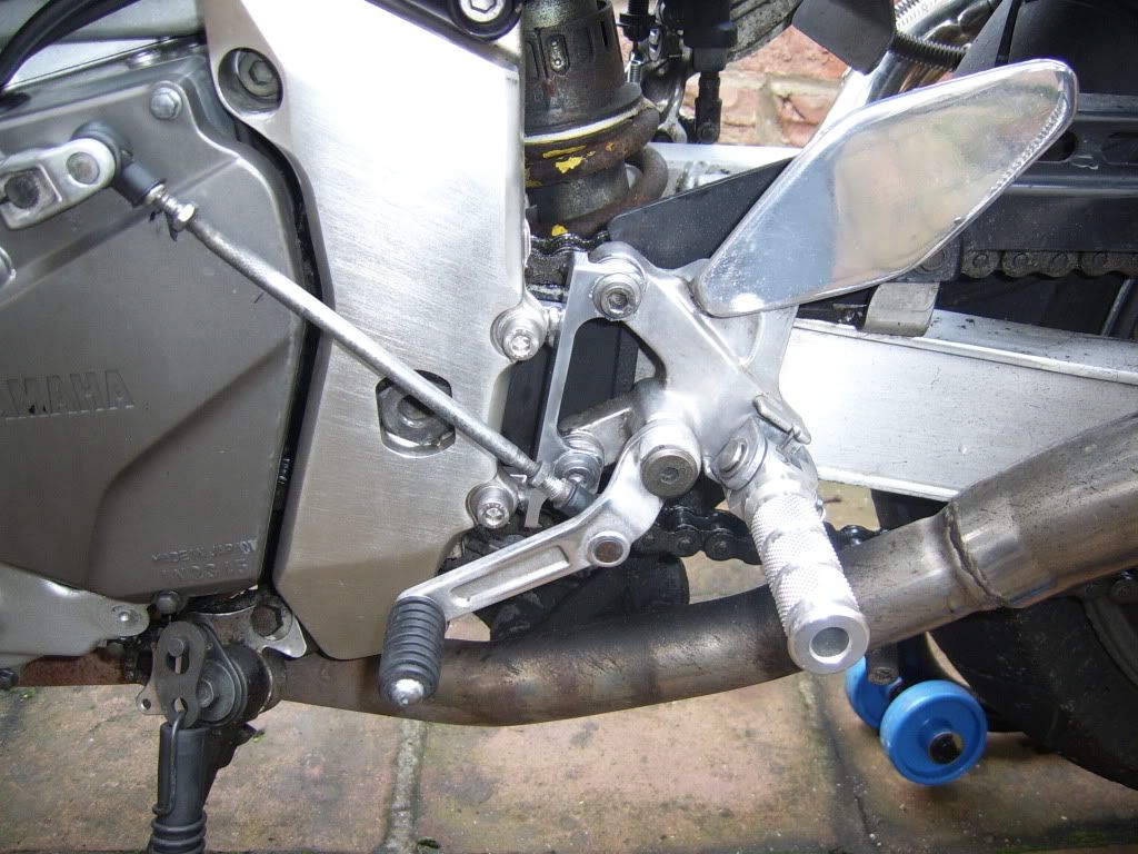

I've been looking to move the pegs on my Trixi for a while now, so I knocked these up today....
Standard peg position:
Adapters bolt straight on the frame....
Bolt standard rearsets back on....
Moves the peg up 20mm and back 27mm....
And the gear peg to match!
Had to adjust the angle of the brake/gear levers a bit, but appart from that all standard parts!
Whaddaya think?
Jimmiboy.

Fantastic idea, neat & simple. I'm guessing you just used mild steel right ? I would buy a set tomorrow or even today ! :lol: What's the finish on them ?

Looks like alloy to me ... :shock:
Did you mill that section out...?? How long did it take and will that welded section be strong enough??

Greg wrote:Looks like alloy to me ... :shock: Greg
I thought that but there's something about the finish that says "chrome wheel paint" or something similar perhaps ? Not sure I'd be brave enough to make 'em out of ally but then I'm a pussy when it comes to stuff like this. :oops:
Come on Jimiboy put us out of our misery would you ! :D
