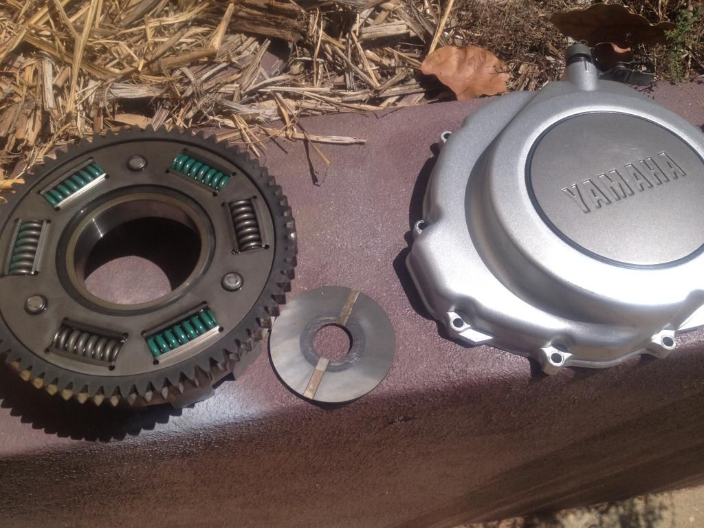

I knew it was somewhere (Thanks Paul )as it was not in the box containing all the parts from this engine case. It was in the engine Alt case itself beside the stator.
The oil pump side complete (although I need to pull it apart to place in the cam chain), the starter gear is now in place but I need to work out a good way to hold the rotor in place so I may tighten it back onto the crank without spinning the crank .
Any suggestions as I don't have the sheave holder tool listed in the manual and I don't want to place a piece of timber in through the small end bearings on con rods.
Once this is tightened next will be to fit the the slipper clutch.

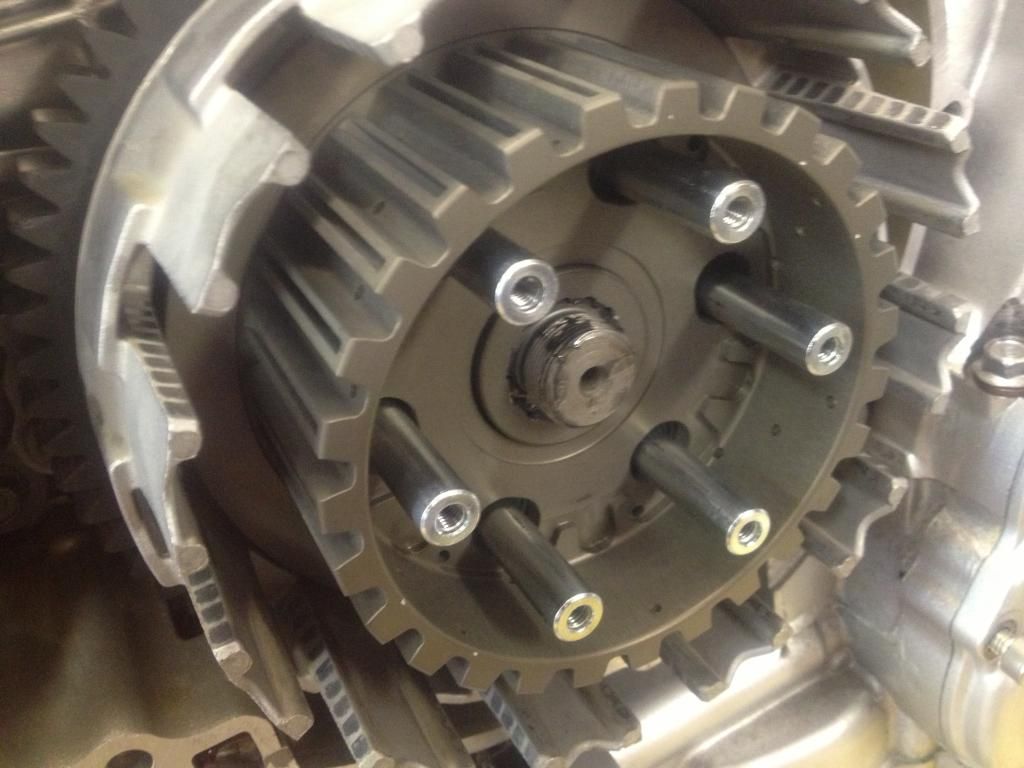

Today was clutch day and prepping the slipper clutch.
I'll post photos shortly of the days fun.

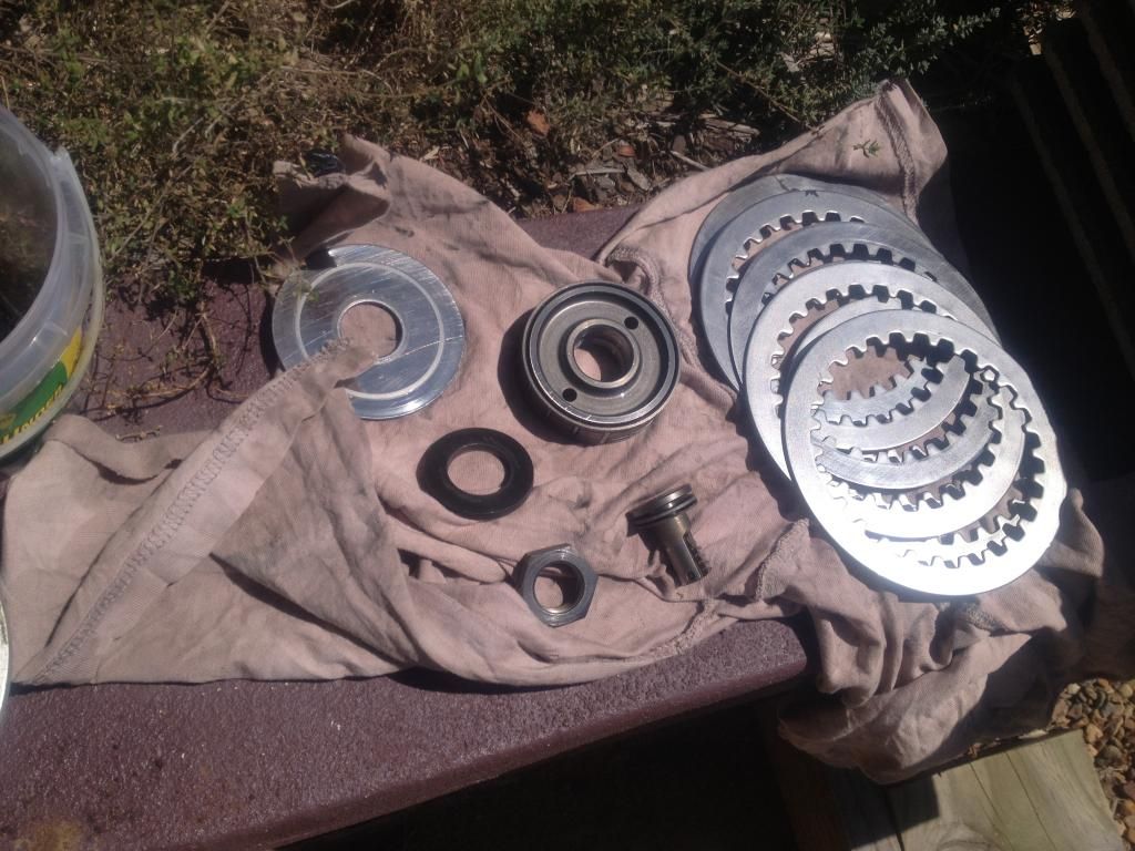

Once all was cleaned in the kero bath it was time to take the original parts needed.

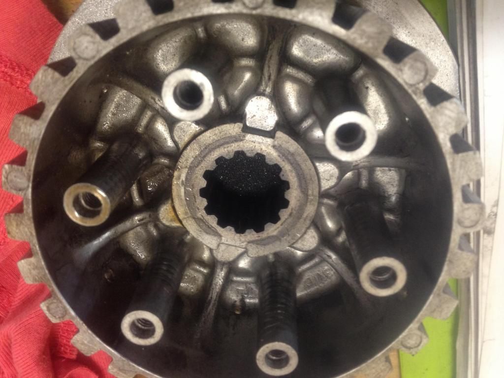

The clutch boss from the original clutch is not needed as this inner section is replaced by the slipper clutch boss.

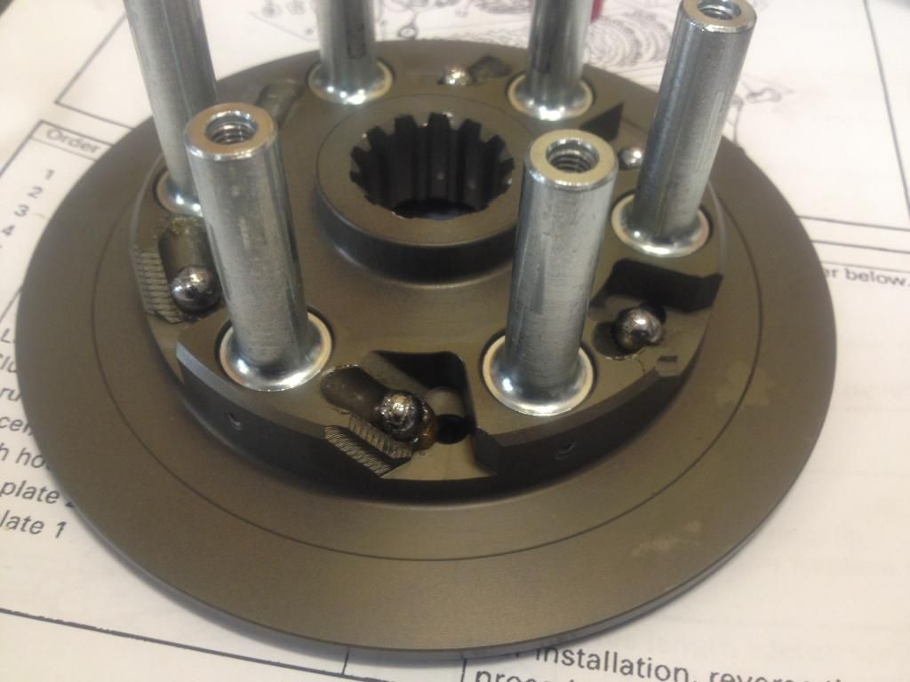

You can see the difference with the original boss on the next photo and the Sigma slipper boss.
The original boss is just one piece where the slipper is 2 piece with a separate base so as the centre rotates and lift separating the plates enough to slip. You can see how the spring mounting poles have elongated holes in the plate for this action compared to the solid 1 piece on the original.

Here you can see the base and the action with the ball bearings as the centre rotates and separates the plates.
