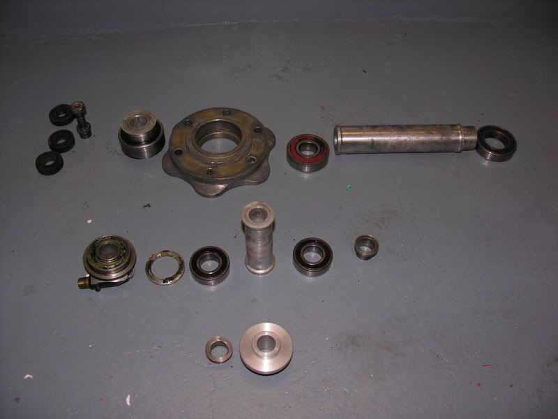

These are the parts I got with my rims. I don't have a picture of the rims yet, but do You "recognize" the parts? (Maybe You have some pics?) I haven't tested the front wheel so far, but it looks to be a straight fit. The rear wheel is a different story. I have opted for making a new axle, 20 mm instead of the 28(?) that is the original YZF size. I suspect someone before me have made up some adapters for the 20 mm spindle...
The bits and pieces I got with the wheels are in the picture They are lined up as I guess they will be placed from left to right. The middlepiece that goes between the wheel bearings, protrudes some mm's to the right, nothing towards the left. Same with Yours?
The bearing package that should sit in the sprocket carrier, is made up of three aluminium pieces and one bearing. This is my biggest concern, as this is the piece that will decide the distance from the swing to the sprocket. BTW, does my sprocket carrier look similar to Your? What sprocket fits to this? I have planned to have some sprockets made, but if You know where to get ready ones, it would help a lot. How flush is the sprocket carrier with the rim? If it is completely flush, what parts are making contact, the bearings+distances, or the carrier+wheel? What is the "free" play when the wheel nut still isn't tightened?

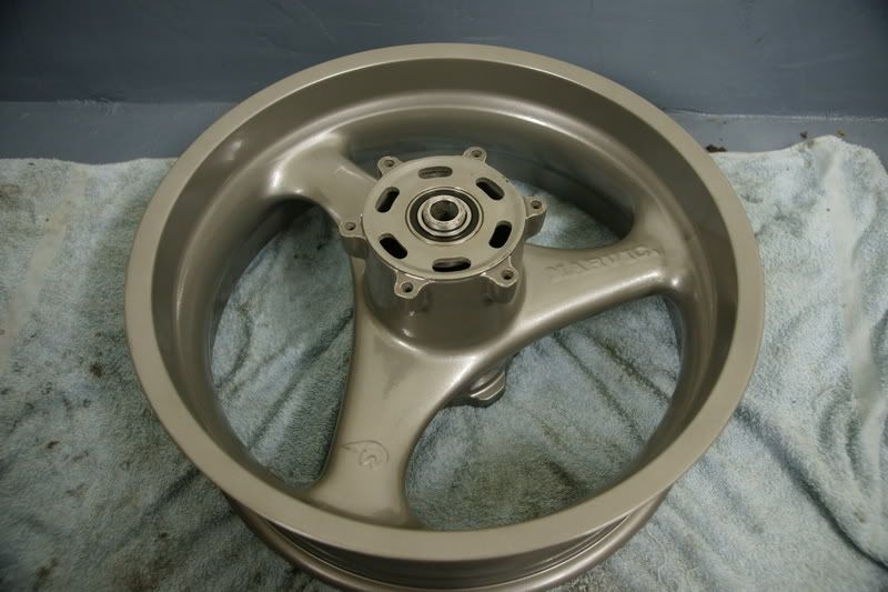

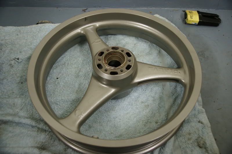

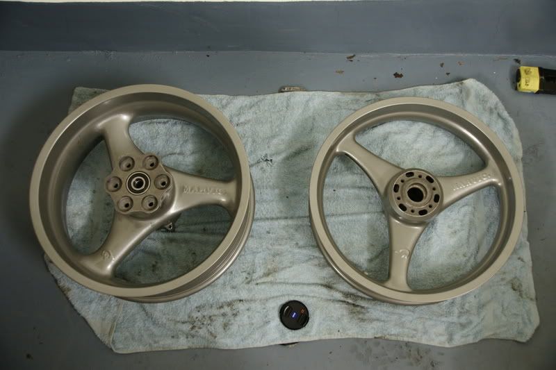

Thanks, I'll patiently wait for Your measurements. 8) My wheels are looking very similar, three-spoke design as well, definitely from the early days... My carrier might have been for another bike from the beginning, but this won't stop me. I'll put some ppictures in here for comparison later this week.

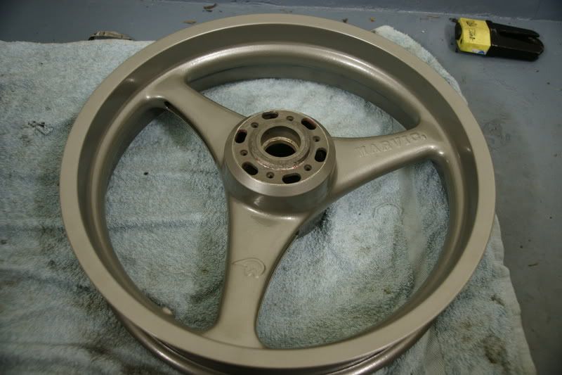

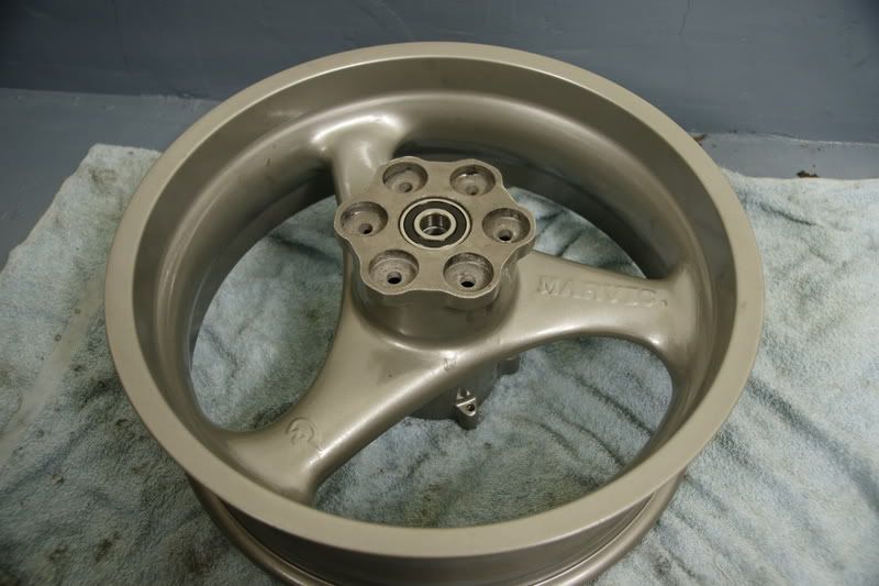

Post by HansJ » Thu Apr 17, 2008 9:20 am
Managed to take some pics last night. Turns out the front wasn't that easy, the bearings I got with the wheels are 20 mm, but all the distance pieces etc that came with the wheels are 17 mm, same as the TRX. #-o A lot of turning will be needed...

Your wheels look totally different then mine, for what it's worth, though.

Thanks for telling me. I am meeting a guy this weekend that I hope can help me out. What's the difference between Your rims and mine? I thought there were only the 3 and th 5 spoke rims, and that they looked very much the same?
Re: YZF750swing, I need some measurements!
Post by Tarwetijger » Sat Apr 26, 2008 10:07 am
Well the spokes looks different but it's hard to tell. I think your wheels are newer.
My wheels look nearly the same as the originals :roll:
