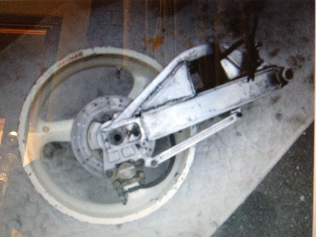

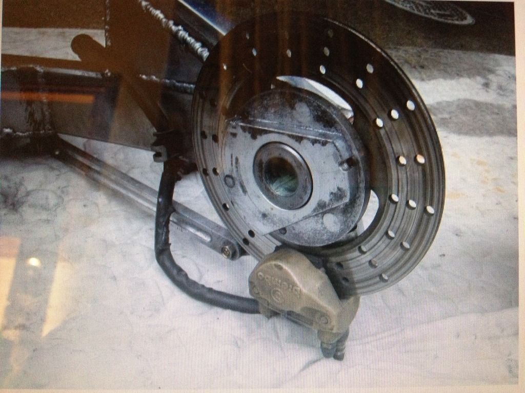

Yes but Alex purchased the bike with it already set up.
Go on Dicky, take the plunge and post up the progress and what machining is needed to fit it all up for all to learn.
Or go down this route and make your own.
This is a YZF 750 rear swing arm that has been modded to a single sided style.
Bit rough looking but could easily be done a bit tidier to a std trx swing arm with a bit of bracing and a little thought.
Just change to a 25mm axle.
At least your wheel alignment, swing arm length, suspension and chain alignment wont be an issue.
You can fit it up with a nice light weight wheel if need be too.
