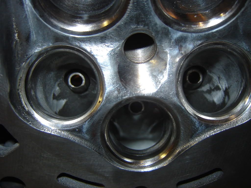

this is what i managed in about an hourGreg wrote:Dunno - it's got 30 mins to go and it's at £195 .... be interesting to see how much it actually sells for and if it's really worth it..!
I've got a spare head that's in the winter overhaul plan - will it be worth getting the Dremel out?
ive since cleaned it up some more , lapped the valves in,, fitted new stem seals, rebuilt the head and done the shims

Nice one Steve ... It's be interesting to hear from anyone else who's worked on their own head rather than having it done, how easy it is, whether a flapwheel on a flex-drive can do the job or if you need to use a die-grinder or something....
Vince made quite a thing about the valve seats being triple cut - does that make any real difference?

pro tip:
280 grit "wet rub" / "wet and dry" / whatever you want to call it..
cut off a thin strip, about the width of your finger.
In and out motion on the floor and roof. So it has the lines going in and out, rather than side to side in a port.
