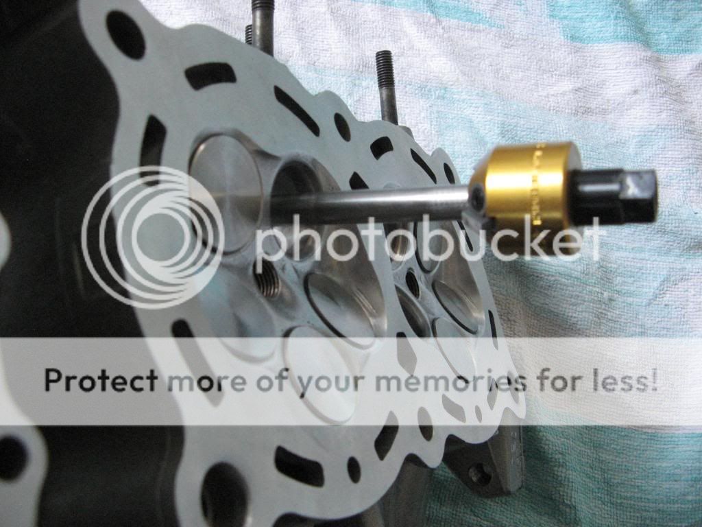

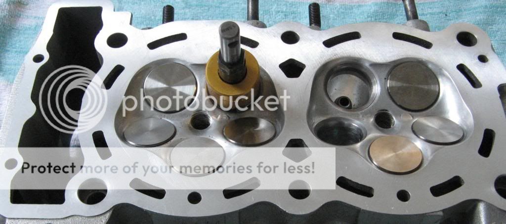

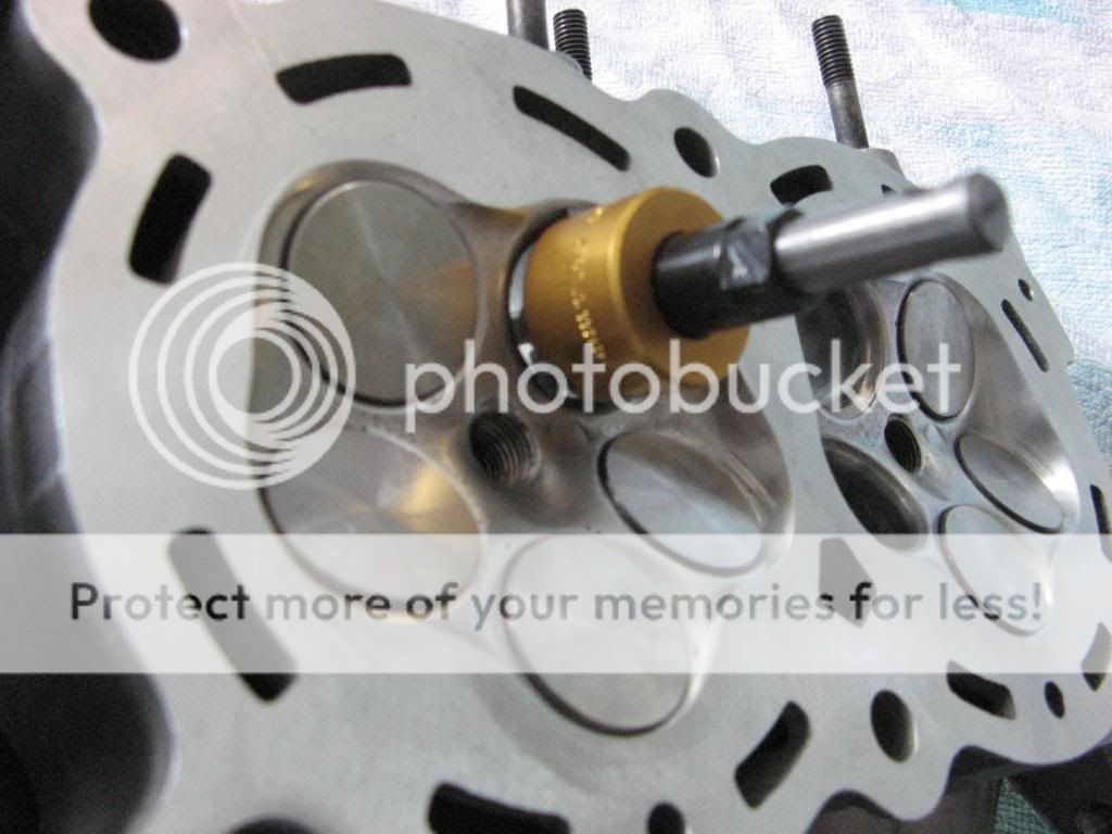

Anyway the head is progessing slowly.The porting is all completed and I am in the process of cutting the valve seats with a fabulous Neway valve seat cutter and then lapping the head seat lightly with a "sacrificial" lap.I'm using Engineers blue to verify seat widths before making adjustments. At first "seat cut and lap" the valve clearances were all over the place,many coming in at more than 2.40 mm (larger than readily available valve shims). Having thought greatly about it I'm also sinking the exhausts a little to try and reduce "crossflow" ie. fresh charge flowing straight out through the exhaust.
I'm cheating a little with the bottom cut becuase I'm too tight to buy a 30 degree cutter. I'm using an engineers "half round bearing scraper" and sharpening it frequently with an oilstone.I can achieve flow enhancing radius bottom cut.
It is all taking a long time but I'm striving to the enth degree to do the very best possible job on this head.
