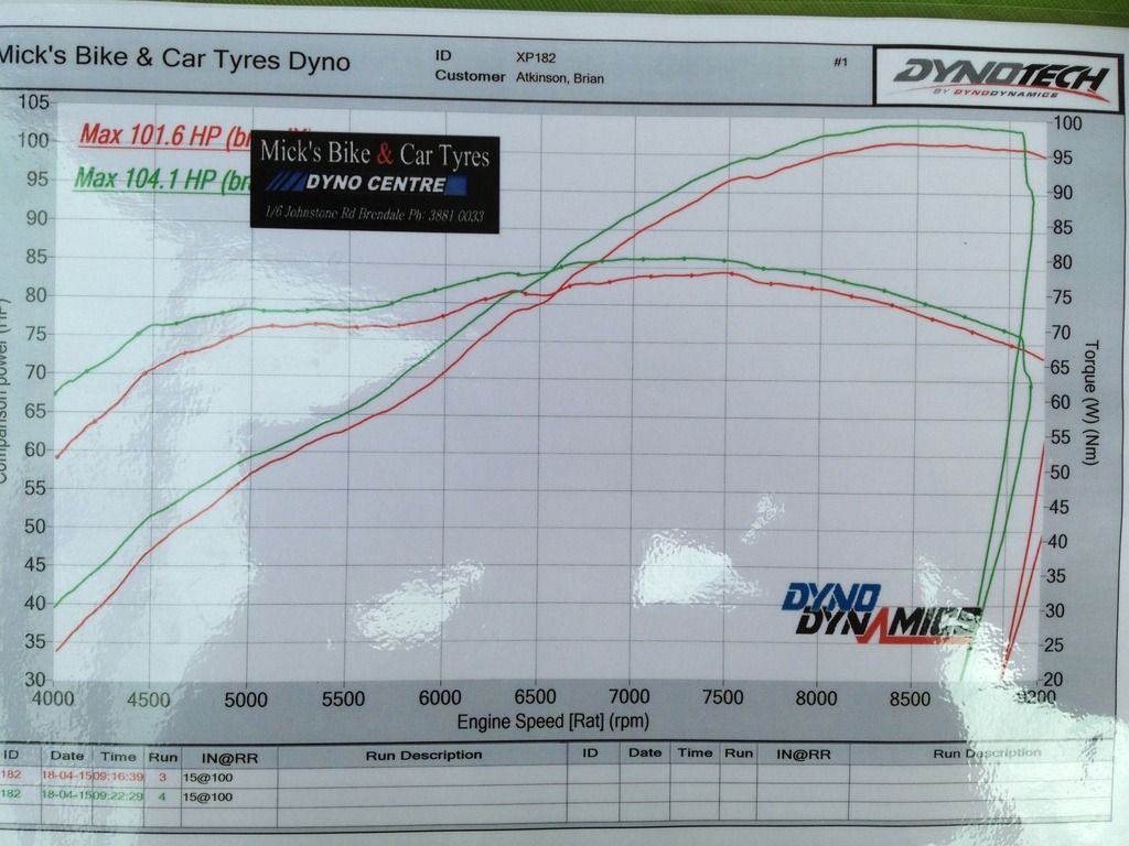

RED line is the 3 degrees retarded map and the GREEN being the std Ignitech default program with TPS.
So forget about my retarded map theory as you can see there is a constant loss all through the HP and torque curves and even the air fuel.
But I can see why Sanddunes lost his midrange as maybe the Ignitech map can be advanced a little more over 4000rpm.
Trixed did an A-B run on his stock TRX with the std ECU and the Ignitech and you can see the gains under 4000rpm and again over 6500rpm.
I will question the Nm result and originally it was in Ft/lb and he asked me after the run was completed if I would like it in Nm for the print out.
80Nm is only 59Ft/lb and a loss from my stock motor with FCR result of 87Hp 62Ft/lb result.
80Ft/lb is 107Nm and 104Hp which sounds more in the ball park looking at other dyno results in similar format.
CORRECTED SPECS AFTER RECALCULATION OF DYNO TO Nm
104hp at 8500 and 71ft/lb at 6700rpm
http://www.trx850.com/phpBB_forum/viewt ... yno#p98812
If you view spandons map you can see he found 100Nm torque too.
The Husky 900 Nuda puts out 105hp and 100Nm too.
Last edited by cobbadiggabuddyblooo on Sat Sep 19, 2015 9:34 am, edited 3 times in total.

Post by Killerwhale » Sat Apr 18, 2015 7:54 am
The green is pretty much exactly what mine pump out on the rear.
94.6 Nm
I might want to try the standard ignitech map then :)

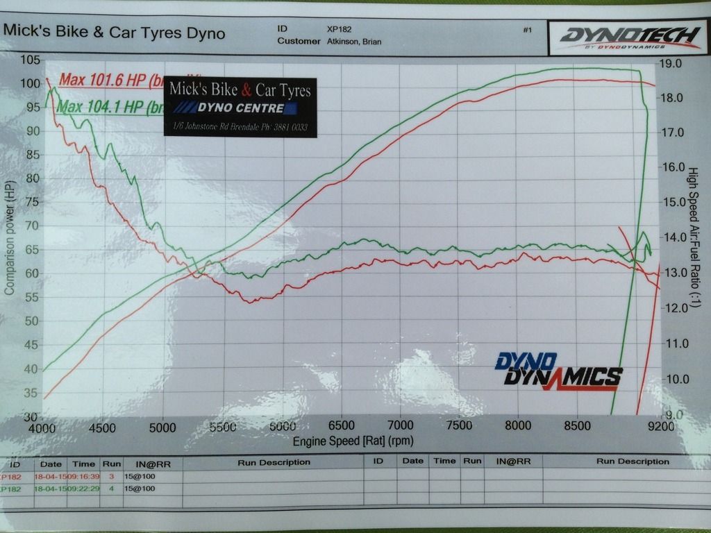

cobbadiggabuddyblooo wrote:Installed a revised ignition map today and bike sounds better, I have my smooth unloaded gear changes back and bike just wants to rev faster and keep pulling after 7,000rpm when you twist the throttle . It's taken away the slight vibration I was getting through the pegs and bars so it's all slowly falling into place.
My O2 sensor kit arrived 5 minutes ago so looks like I'll be doing a little rewiring with the new loom through the week.
perfect as they are predicting rain anyhow.
So I can see if my assumption of lifting the needles was only feeding the default TCIP4 curve which is now working as an advanced timing map due to the higher compression.
More fuel making for a slower burn, richer mix to compensate for the advanced timing to get timing back to optimum. Not the way to go about things.
So I'm very happy with the timing improvements with this new program.
Now it's time to check my air/fuel ratio..
So what have I learnt today... :joker: :whoopass:
Assumption..
Yes assumption no consumption ..
Two vital mistakes. I lifted the needle to give me more fuel and changed timing at the same time.
Whatever gains I felt and assumed it was timing was more like the result of more fuel.
Next dyno run I'll try with a slightly richer air fuel mix and default IGNITECH map.
This way I can get another torque curve to dispell any doubt there too.
Something to shoot for and book in for next months dyno day.
The dyno guy did a couple of extra snapshots with different throttle and rpm readings for me too so I'll see how the Air/fuel gauge system I have set up compares to the dyno results.
If I gain some with a different A/F ratio next month, I'll book in to see if I can sneak any more out of the timing.
I'm sure there are a few sitting back with a smile on their face thinking I told you so :lol: :lol: but that's all apart of my learning curve.. Sometimes you have to stick your finger in the boiling water and go #€UK that's hot :lol: :lol: :lol:

Post by cobbadiggabuddyblooo » Sat Apr 18, 2015 8:56 am
Ok I think maybe I can see where the confusion is coming in here on torque readings.???
You can see on the dyno result there is a HP reading that finishes on the RHS around 95Nm but this needs to be read on the LHS which is HP.
The Nuda 900 figures are quoted at the CRANK no the rear wheel so you would look at a ballpark of 87Nm and 92RWHP.
The Nuda has a longer stroke (81mmx80mm) so you would expect a higher torque figure and lower HP reading.
I'm also running a lighter rotating mass so again this may factor in why there is a little less torque.
Looking at my other dyno results.
Stock motor with staintunes 76hp and 59Ft/lb
Stock motor/ FCR's and l/bore. 87hp and 62Ft/lb
Trixed std TRX result today. 72hp and 49Ft/lb (fuel ratio issues)
So today's result of. 104hp and 59Ft/lb can not be correct.
Udaysen should post his results up shortly I would imagine.
A little homework and gentle reminder to kick my butt with.
This link explains what I have achieved with the power/torque curves.
http://www.epi-eng.com/piston_engine_te ... torque.htm
Last edited by cobbadiggabuddyblooo on Fri Dec 11, 2015 1:32 pm, edited 1 time in total.
Post by cobbadiggabuddyblooo » Thu Apr 23, 2015 5:56 am
Was over at the dyno shop today and explained it all to him and showed him the corrected result.
He said, AAAAhh that will be why a few people had mentioned it was down on torque than expected. :lol: :lol: :lol:

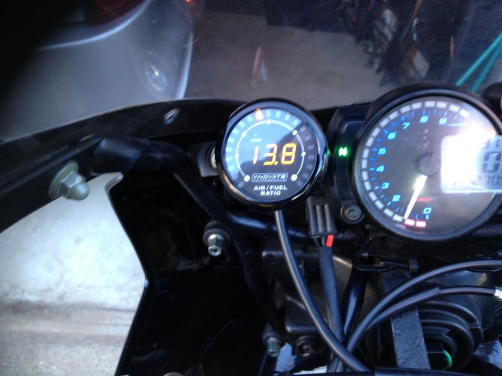

Post by cobbadiggabuddyblooo » Mon May 04, 2015 7:50 am
Started a little tinkering and got a few readings today with the O2 sensor.
I put a 20mm long piece of white tape on the throttle grip by the body and placed a black line as a reference pointer.
Then placed another 50mm piece of tape on the throttle mounting body and marked my 0% 25% 50% 75% and 100% with a small red dot in between to give me 1/8 references.
Note 50mm long tape gives me 0%-100% at each end due to the 60 degree throttle I'm using.
If running a std throttle twist this length would be around the 80mm mark .
Carby's have been balanced and float levels set previously.
So my fuel screws are both set,
No.1 is at the std setting... 1 turn out ...and No.2 is screwed... 1/4 turn in..from std to just richen this cylinder to get me both hovering about 13.2.
(this screw is accessed through the hole in the fuel bowl body close to the inlet manifolds )
Riding in traffic and using 1/8 throttle 2nd to 4th gear I'm at about 11.6 to 11.8 and running from idle to about 4,000rpm.
A little rich so I'll try to screw out the slow air screw from the std 1.5 turns out to add a little more air and see if this leans out my readings closer to the 12.5/ 13.0 mark.
Screw the throttle from 1/4 to half throttle from 2,000 upto 4,000rpm I'm happy with a reading about 12.6 -12.8.
but open the throttle any further and I start to find the 13 and over readings with 13.7 a constant from 1/2 to wide open throttle through the rev range.
This only confirms what readings I was finding from the dyno run so calibration of my own sensor and the dyno sensor are reading the same.
(note.. There is a simple couple of steps to calibrate a sensor built into the Innovate gauge so as the sensor ages or I change it for some reason, recalibration is not an issue )
So tomorrow I'll change the main fuel jets from the std 150 to 155 (accessed through the fuel bowl bung)
and screw out the slow air screw another 1/2 turn which lives by the main air jet right beside bellmouths.
I'll see what readings I find and post them tomorrow.

Post by dandywarhol » Mon May 04, 2015 10:06 am
I'm no dyno expert by any means but dyno runs are conducted at WOT (wise open throttle) and running solely on main jet.
Your last readings just above half throttle are not fully on main jet Brian and would be a bit rich by my reckoning for normal running through the throttle range.
Stoichiometric/Lambda 1 air-fuel ratio is 14.7:1 by weight, anything less than this isn't properly burning all the fuel efficiently. The figures of high 12s is fine for under acceleration and producing max power but how often are you running at full throttle apart from the track?

Post by cobbadiggabuddyblooo » Mon May 04, 2015 12:53 pm
Thanks for the input guys,
That's the beauty of a O2 sensor i have a constant A/F reading at any revs, throttle position and load.
Yes thats true dyno reading are at WOT.
I find any throttle position from about 1/3 to WOT gives me a leaner mixture.
Following the FCR tuning manual, I need to get the main fuel and main air jets right at WOT before addressing the needle.
I've placed in the 155 mains and I'll read this through the rev range at WOT.
From around 6500 to 9000(limiter) its pretty consistent at 13.7(+-.1)
If I get a similar line just richer ( 13.0 for example) with no change at the end, I'll know the 200 main air jet is suitable for a 155 main fuel.
If it leans out right at the top,( eg. 8-9000rpm)I'll try a 190 main air and visa versa, if its a little rich right at the end, I'll try a 210.
The main air also can influence how the fuel atomise's due to how the FCR's work through the emulsion tube.
I've a jet kit that gives me from 140 to 170 in 2.5 increments and main airs from 180 to 220 in increments of 10.

This may help understand if the little flattening of the curve at 5,000rpm is fuel or timing related.
I'm currently running the default program just with 8,000rpm advanced by 1 degree and 9,000 by 2.
The torque curve on the -3 map that I advanced at the top end actually closes and shows improvements but the a/f on both remain constant.
