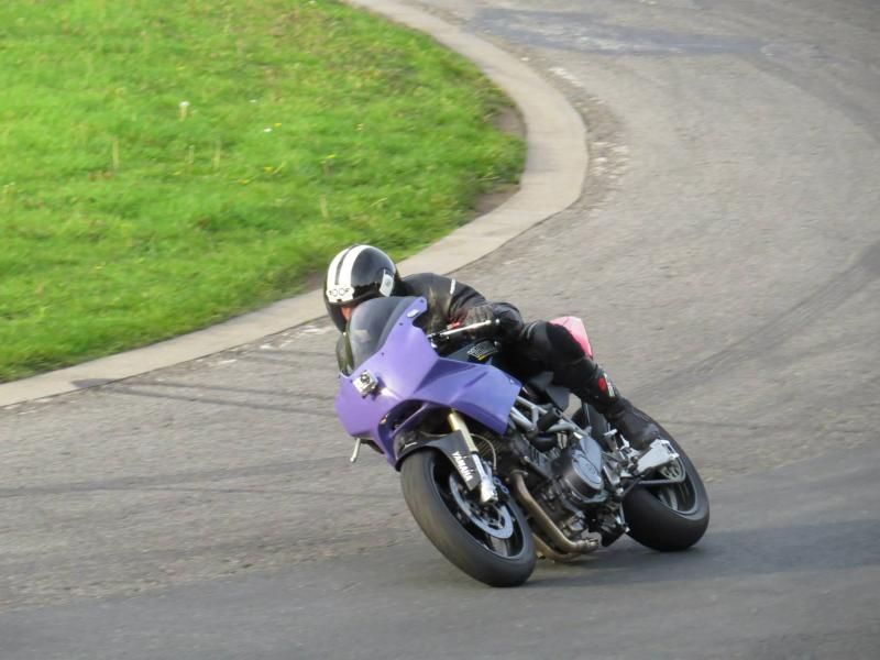

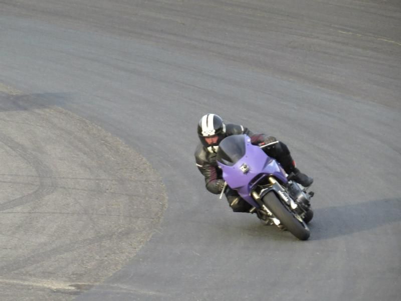

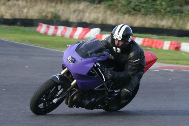

Second track day done, was better than the first. really starting to get to grips with the bike now. I hadn't rode a proper sports bike for years and it felt a little alien to me.
I am really impressed with the pace of the bike, I expected the litre sports bikes to be streaming past me on the back straight but they arent really, and the braking on the thing is out of this world! Still having a little problem with the front mudguard touching the radiator on heavy braking. My forks are definitely bottoming out as I have done the cable tie test. I cant understand of all these trx's with R1 forks no one has had this problem?
I am having a little bit of a problem with the rear spinning up out of corners (no its definitely not because I have casey stoner levels of ability) but I think that might have been down to too much pressure in the rear tyre. I will let a bit air out for the next one.
some excellent pics by a very friendly track day goer.

Looks like a lot of forward biased weight towards the front coxxy - tail high/front low. although the forks are being compressed by cornering (impressive angles for a noobie :lol: ) there doesn't look like a lot of reserve travel on the forks for heavy braking.
You could try lowering the back a bit and raising the front - it would help with yer Stoner/Mccoy spinning antics too 8)

Hi Al, what makes you think there is a forward weight bias? The tail on my bike is about 4 inches higher than stock so it does give the impression of a little arsend up. I was definitely bottoming the forks out on heavy braking, but look at the rear swing arm position in relation to the horizontal - the back end is quite compressed too is it not?
Also something to note that is a big long 180 degree corner so I wasn't really on the throttle much - that compresses everything does it not?
I have just actually lifted the back up about 15mm with some shorter dogbones. I may have to take them out?
I appreciate the input Al. I think it has the makings of a great bike, it just needs some proper setup.
