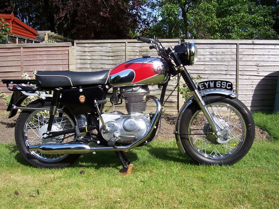

Ah yes,there you go in all it`s chrome plated tanks glory.
- steve speed
- Posts: 1780
- Joined: Sun Jan 14, 2007 9:11 pm
- Location: rochdale England
Re: Help I have killed it !!
very nice that slow codger !!! now take that yellow zip tie off the swingarm holding the speedo cable and fit a black one
and the one on the downtube as well !!!
