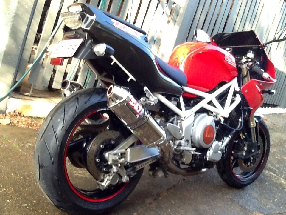

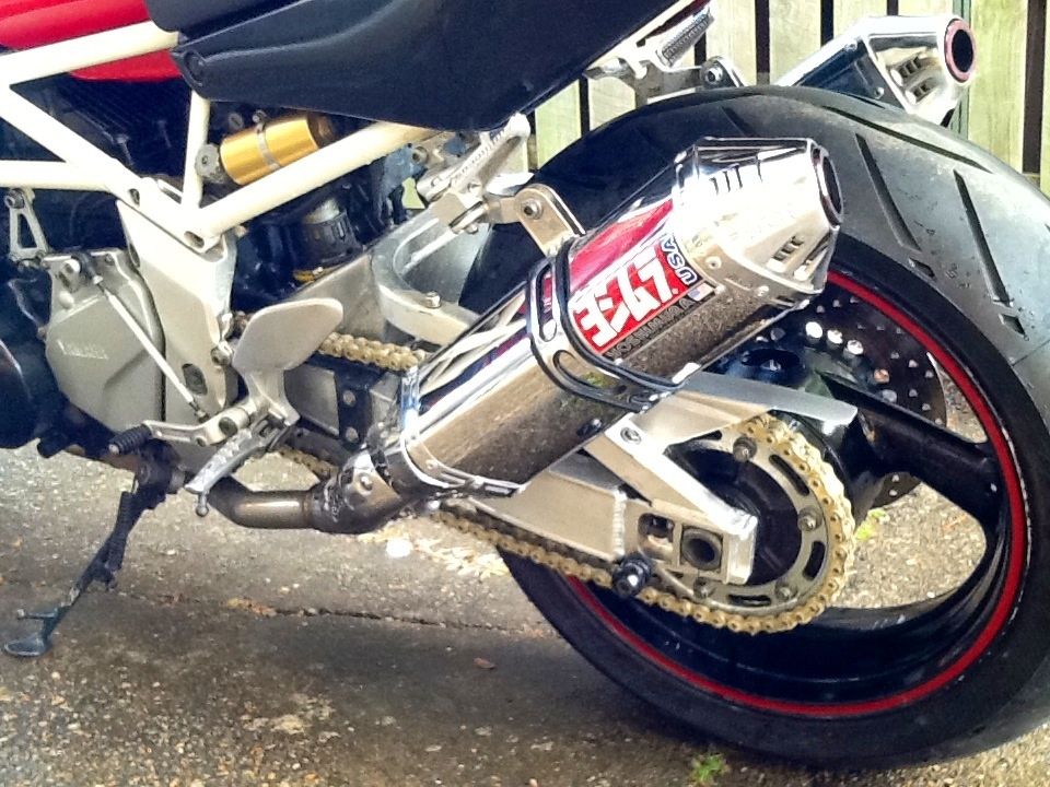

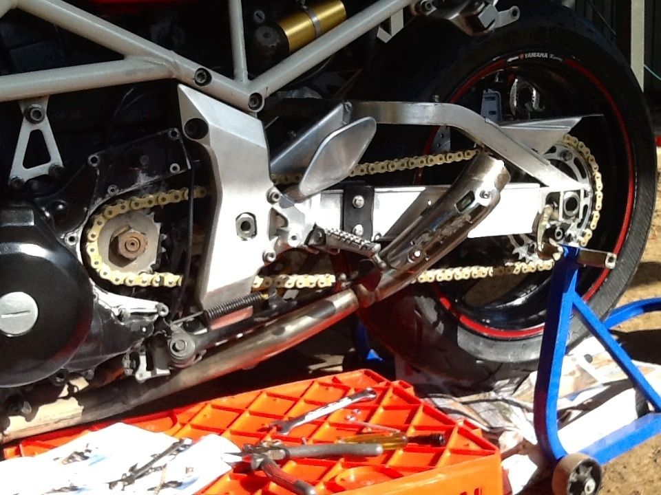

Post by Trixed » Mon Sep 16, 2013 3:16 pm
http://i1317.photobucket.com/albums/t63 ... 796bae.jpg
http://i1317.photobucket.com/albums/t63 ... ad3615.jpg
http://i1317.photobucket.com/albums/t63 ... edf619.jpg
Fitted up the swingarm yesterday. Feels more stable and well planted on the rear. Oh by the way both pivot bearings and the bolt were rusted and the bearing were jammed. Lucky the swingarm had decent bearings so I could finish fitting up. Also funny enough the pivot bolt actually stripped the threads on the nut and the bolt. Metal fatigue?? Glad I pulled it apart as some of the bolts had no grease either and corroded. Managed to put the wheel axle bolt left to right instead of the other way round.
Flipped the Sprocket over and has JT logo and markings facing out. There is a clicking sound from the chain at low speed. Maybe flip again and have a see? Thoughts?
RK Gold Chain is a GXW Ring Racing Chain.The motion pro PBR tool is a magic. A must have for hassle free Pressing, breaking and riveting. Just gotta have the calipers cleaned and refitted. Thanks Alex and Rich for your advice.
