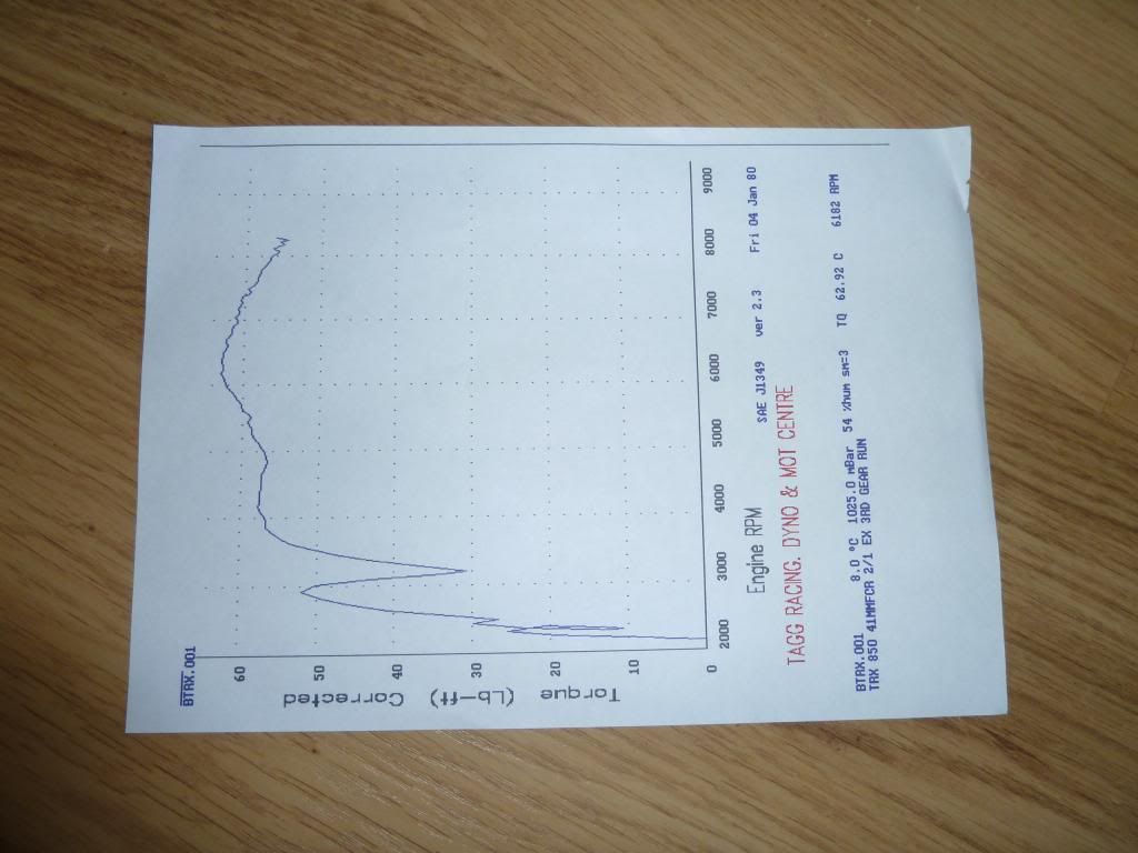

Have attached recent data plots from Tagg Racing in Kent.
Pretty much the same as other similar spec motors that I have seen posted.
878JE, stock head and cams, FCR41 (160 mains) with Ramair filters over bell mouths, Akra headers + Devil can,
Looks like a dreadful hole in the torque and HP at about 3000rpm; he tells me that it bogged down when he did the 3rd gear run and I believe him as I have never felt this when riding. Pulls like a train from low revs in all gears.
Quick way to finish off a tired crank a week after this run.

Thanks for posting those up Phil. They're always interesting,especially so to me as I'm using the same dyno to chart the development of my own motor.
Hope your rebuild is on course :) .

Nice to see curves for a relatively standard TRX.
I don't get too hung up on the absolute numbers. Dyno calibration status is often (always?) going to be an unknown and so caution is needed unless runs are performed on the same dyno. Measures will not be reliably comparable from different sources.
Sounds like I'm making excuses for my 88rwhp. I'm not. Money well spent for me at least but then it is my passion away from family life and it is by far the most fun bike I have owned.
When I ride my TRX with the mods listed it does not compare to how it was with a stock motor. It still amazes me how I can stay with so much modern machinery (1000's, 600's etc) on track despite having <100hp. The power delivery is what does it for me and the ease with which you can ride it fast. High corner speed, great brakes (YZFUSD's) and torque to pull you out of the turns. Lovely.
