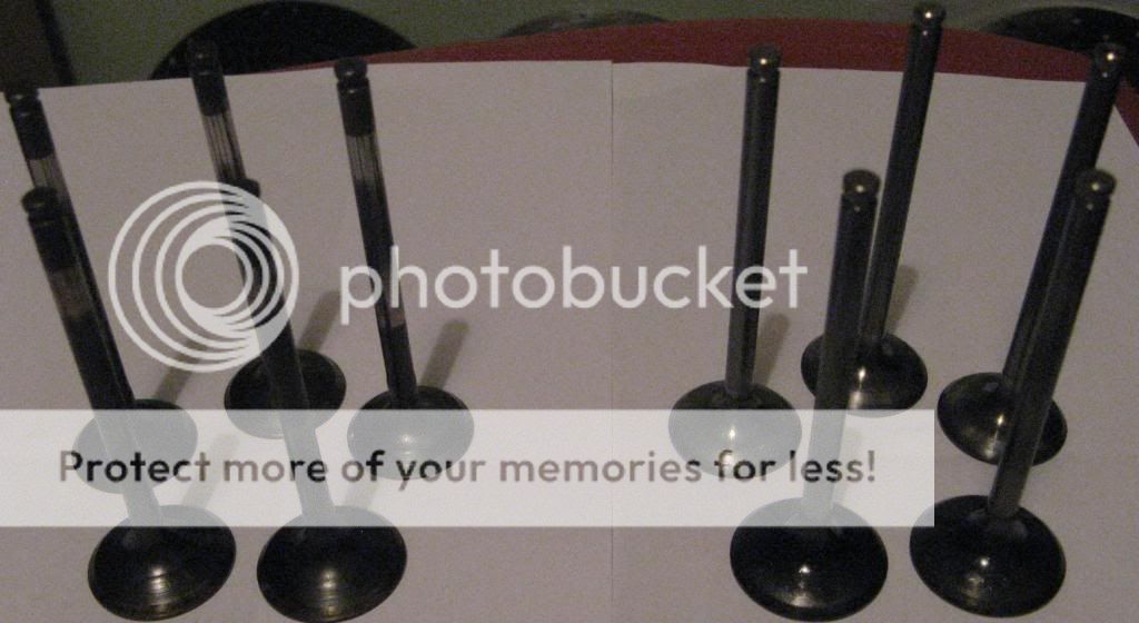

Some of the new oversize valves
Five std valves (left) and five new oversize valves (right)

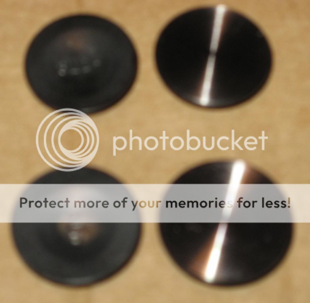

Std inlet v oversize (top) with std exhaust v oversize exhaust (below)

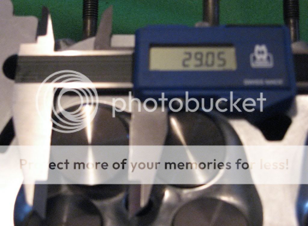

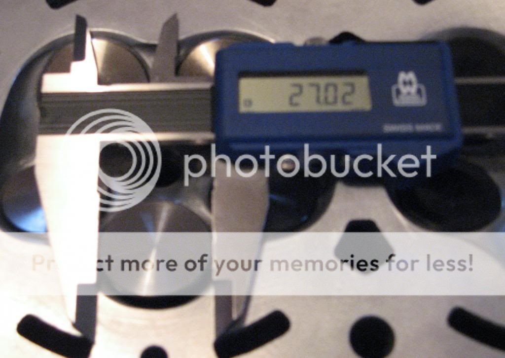

Sorry the last photo was blurry,the camera doesn't seem to want to focus :( . I'll try and bring my vernier caliper home from work tomorrow so I can show more clearly that the new valves are 1mm oversize. I never use it home,much prefer the feel and accuracy of a micrometer :)

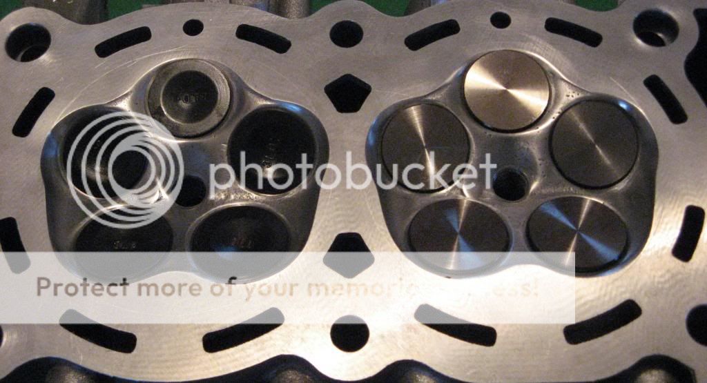

Std Valves compared to Big Valves sat in the cylinder head that I'm in the process of modifying. Big valves are still sitting high at the moment as I haven't cut the seats yet.
