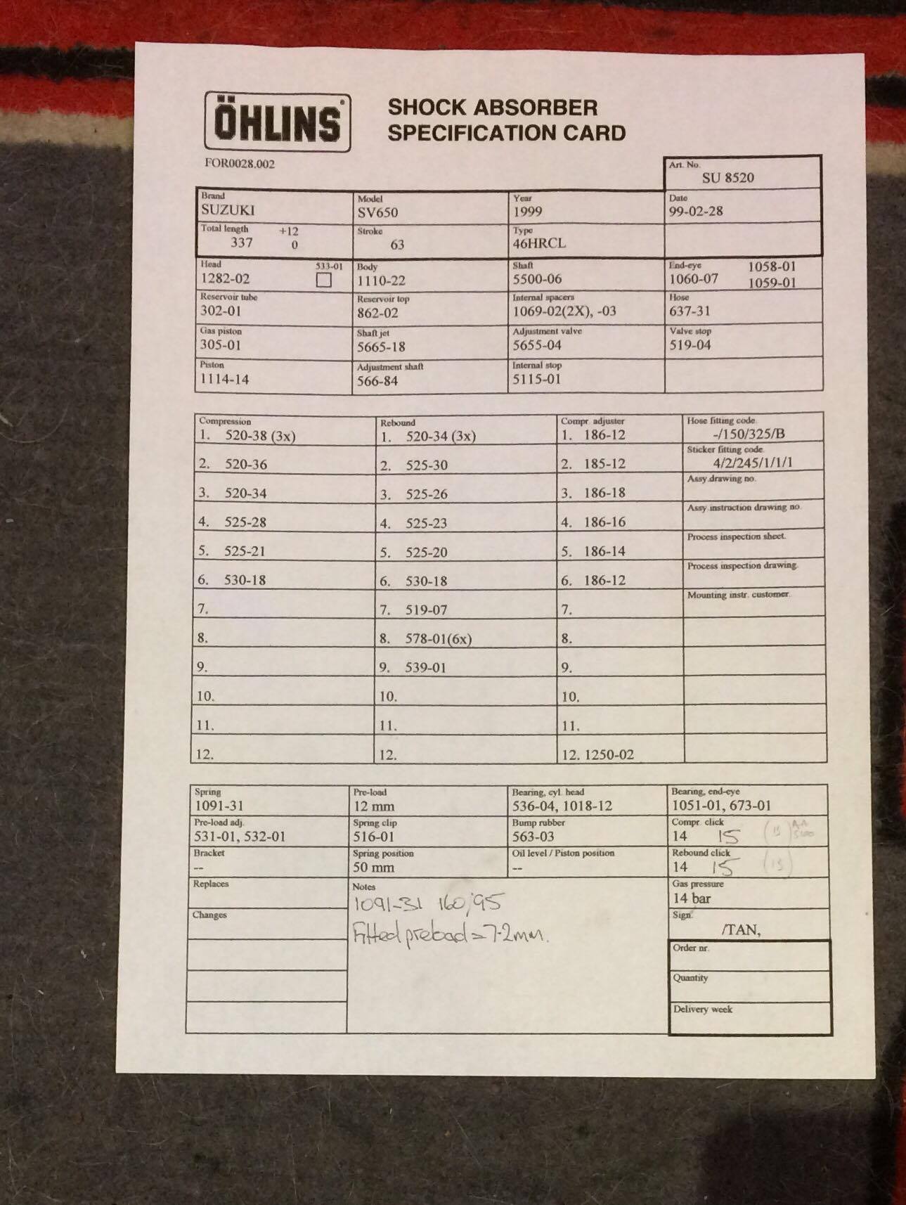

I ended up using an Ohlins from a '99 SV650. It fits pretty well straight off the bat. The Ohlins spec card is at http://www.ronketti.org.uk/ohlins_spec.jpg - spring rate is pretty good for me on the road. Could do with some setting up for exuberant track use, but for something that was never meant for the TRX, it's worked out pretty well. The only thing I needed to change was to knock out the threaded inset from the bottom mount clevis - it was a press fit, and just popped out pretty easily. The standard TRX bottom mount bolt then went straight through, no problem.
