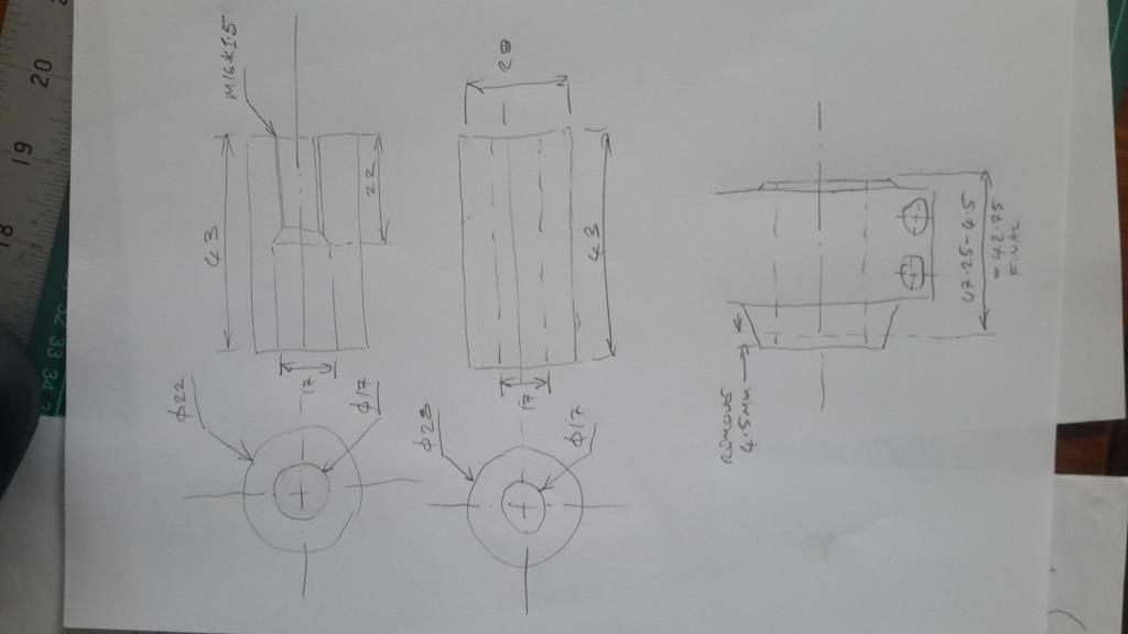

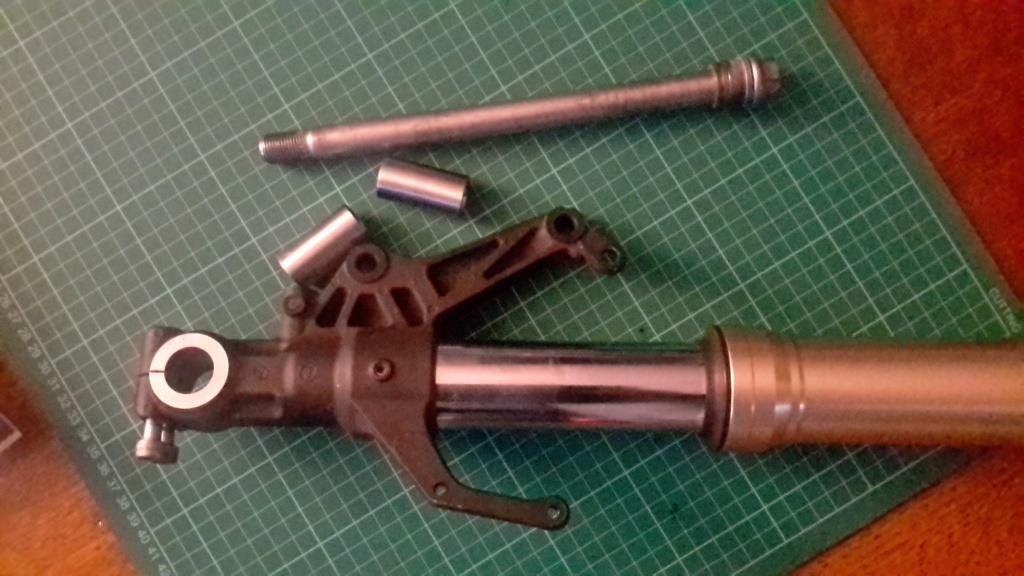

I've been making some progress to interfacing the TRX front wheel with the later R1 front end. Needed a couple of bits turned up and a bit machined off the LHS fork leg:
It's gone together ok and the wheel runs true and central without any binding.
