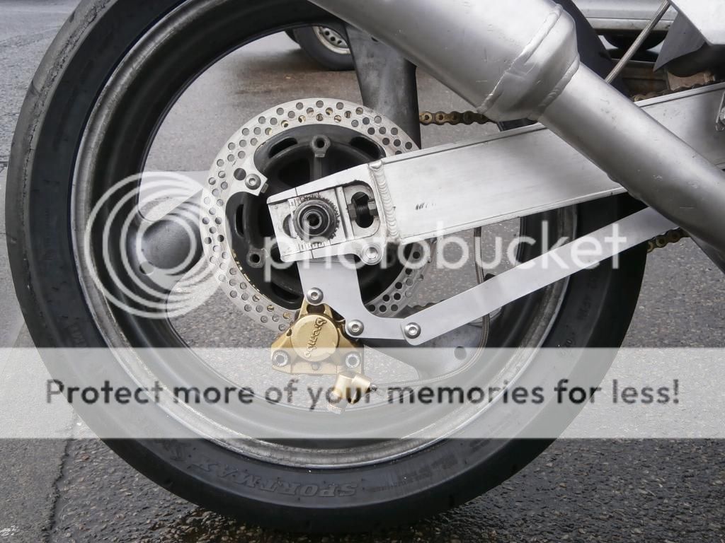

Kayla wrote:Here's the lightweight disc and caliper set up on my 400 (TRX wheel and swingarm)-
Surely you can drill some holes in that torque arm & carrier? :lol:
Kayla
Posts: 1670
Joined: Fri Jul 04, 2008 7:49 am
Location: County Durham
Re: TRX winter diet
Post by Kayla » Tue Oct 22, 2013 1:37 pm
That's the prototype, the production version looks like a doily :lol:

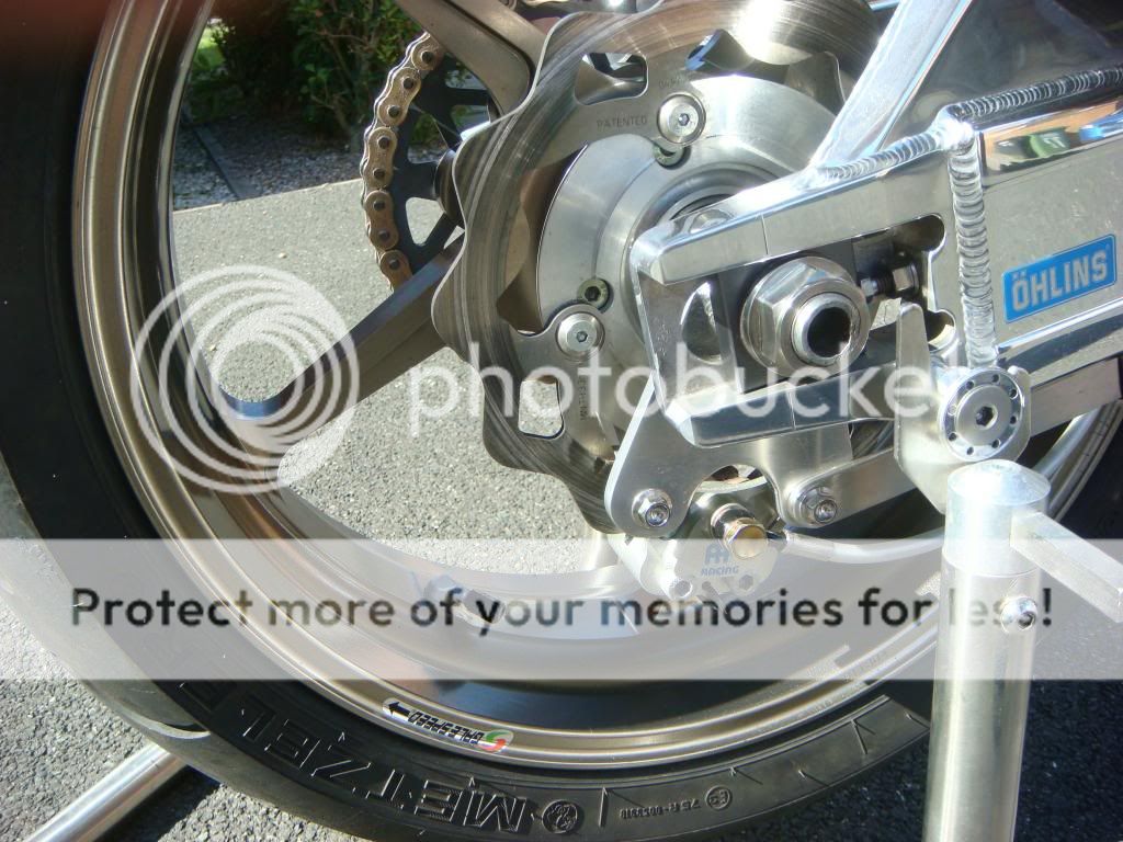

Post by NWS870R » Fri Oct 25, 2013 9:49 pm
My 'dieted' rear brake set up:

Post by coxylaad » Fri Oct 25, 2013 10:14 pm
hell's teeth that's a bit shiny!
