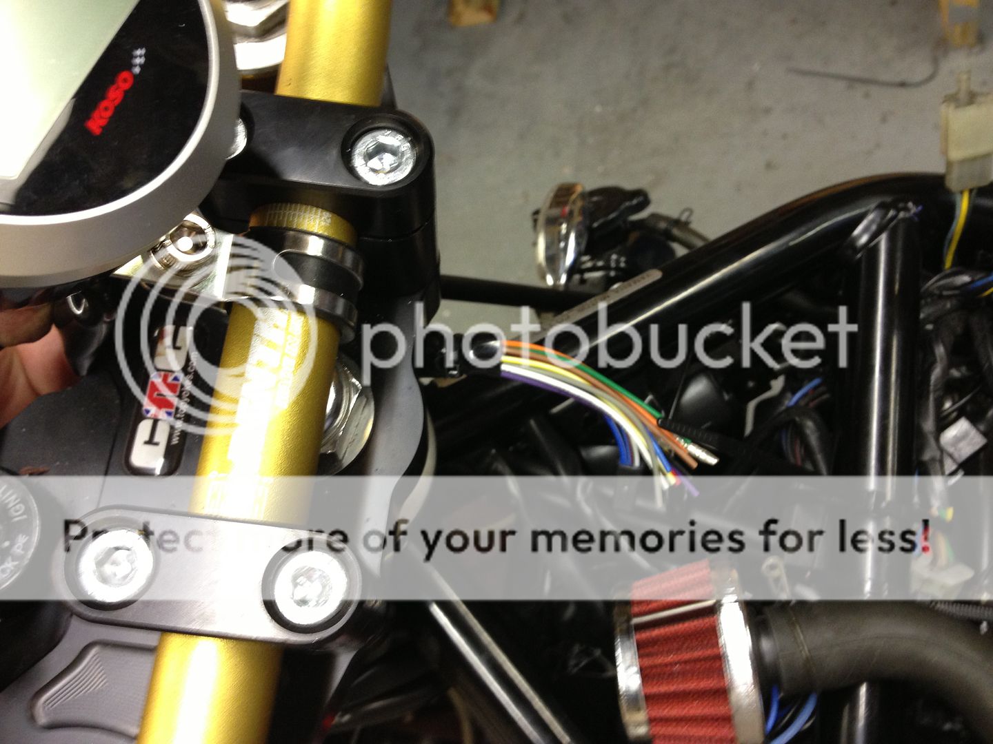

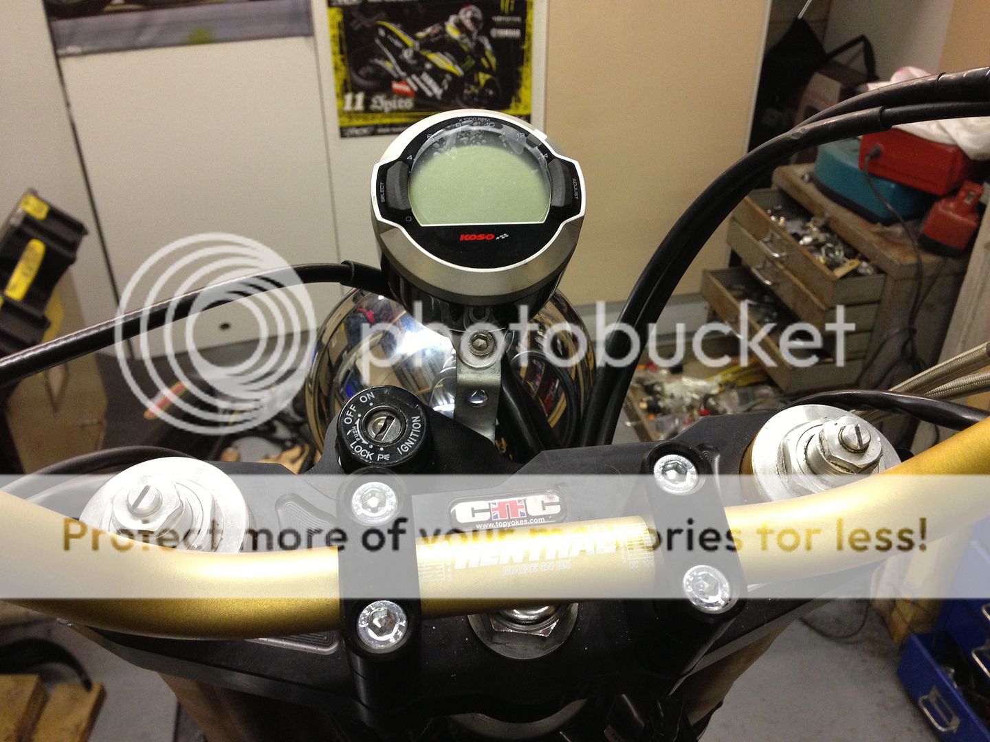

Ended up getting a Koso http://www.digital-speedos.co.uk/dl-03sr-563-p.asp

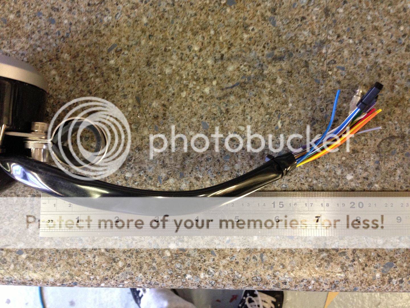

I like the look and the functions, its pretty easy to wire up,,,but I'm an electrician. What I was pissed off with though is how short the loom is,
I've got it mounted in front of the yoke now next to the ignition and the loom wouldn't even reach the tank :shock:
That's just pathetic, and it took me 3 times as long as it should have because I had to solder extra length in to most of the wires. You won't need some of them. I got the winkers, full beam/flash and neutral light and rev counter going. I'll get the oil light sorted when I get a switch to suit me gizmo I got off DixonJ.
Next pisser was the fact that its impossible to get the speed sensor mounted properly on me Yzf forks and its not close enough to the magnets, so no worky. I'll need a cable drive adapter.
I'm complaining about the length of the loom and the sensor situation. So hopefully I'll get a cable drive thrown in. If you spend £150 on something it should be perfect.
But, it looks cool on the bike, very minimalistic and does everything you need. Trip meters, you can set a warning flash at a given mileage to warn of low fuel. Does all sorts really, most of it you don't need. I just like the look of it.
