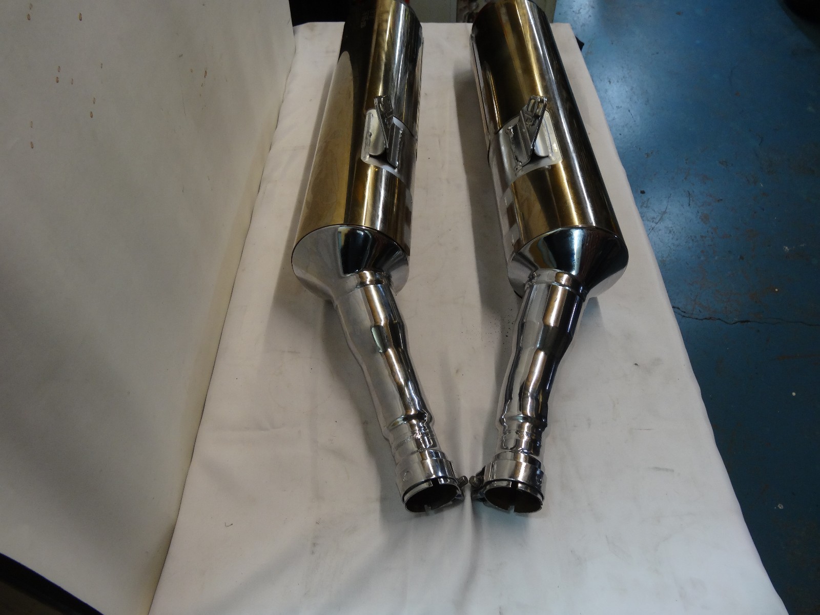

Anyone gutted the stock cans completely and converted to traditional "absorbtion", or "straight through" or "race" mufflers (whatever the terminology is) using perforated tube and packing material such as Acoustafil? Is it possible?
I'm guessing the trick would be separating the front end from the can and getting it back on again. Might require shortening slightly to hide the cut?
https://i.ebayimg.com/images/g/hasAAOSw ... -l1600.jpg

Total fallacy gutting the cans...most motorcycles are designed so that the whole system, carbs, airbox, exhaust and mufflers work together to give a broad spread of power, by gutting the cans all you will achieve is more noise and that's what most people perceive as more power. This is the same for the airbox (designed to achieve optimal resonace for the CV carbs) etc, as these engines run CV carbs and there is very little you can do to rase HP. If you want more noise fit aftermarket mufflers (the originals are getting harder to find), If it's more HP...then stick it on a Dyno and then tune the engine/carbs etc, this will optimise the HP available and give a smooth delivery of power with good fuel economy.Trx envy wrote:Anyone gutted the stock cans completely and converted to traditional "absorbtion", or "straight through" or "race" mufflers (whatever the terminology is) using perforated tube and packing material such as Acoustafil? Is it possible?
For more HP fit FCR's and start spending $$$$$$$$. Most fit 41mmFCR's which work very well in the mid to high RPM, I personally like the 39mm FCR as it will give better flow at useable RPM as well as giving great HP increase in the mid to high RPM, to unleash all the HP from the FCR's fit a complete quality aftermarket exhaust system designed for the TRX and a cold air box with pod filters.
The TRX is more about smooth torquey riding than outright power, grab a smooth, twisty, climbing and mid speed road and the bikes secretes are exposed, I'll constantly embarrass much faster bikes, I stay in touch with litre bikes over my favourite 47K's of road, the crazy or super experienced riders will always get away from me...
Once again change your thinking with the TRX, rebuild the rear shock, as most are over 20 years old and the oil is well and truly stuffed, fit a quality spring to suit your weight (these shocks were made when Yamaha owned Ohlins so incorporated their designs wisdom).
Same with the front end, new oil, better spring to suit you weight, emulators, blue spot callipers and master cylinder and then ride the wheels off it
These will always be a 1995 design and that's what some people forget...
