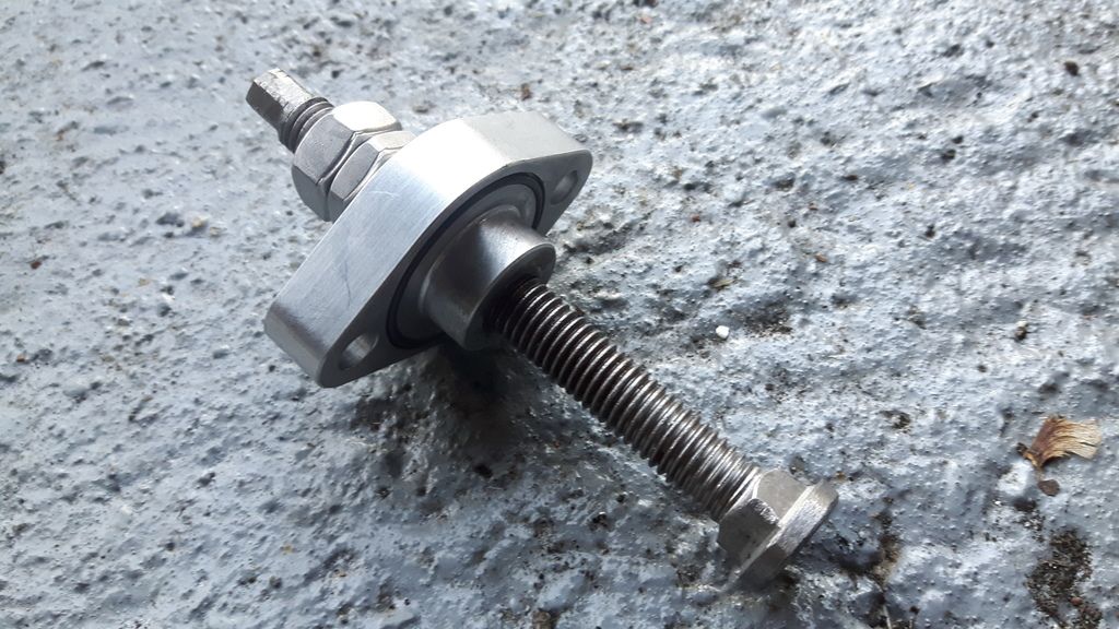

Turns out the Cam Chain Tensioner from a lot of different bikes will fit the bolt pattern and position, but the reach isn't long enough. I bought a DRZ400 MCC from ebay, really nice bit of kit, billet machined body with an o-ring groove rather than paper gasket, tensioner stroke was about 20mm too short so I've fettled an A4 Stainless bolt to suit, pretty pleased with the end result. I'll post some pics when I get a chance.

Piccies:
