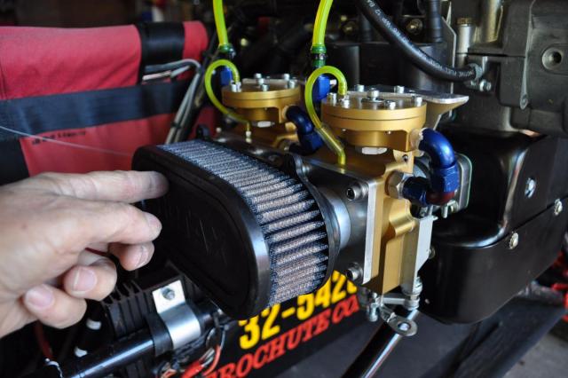

"We are through the looking glass gentlemen" if you want truly Left field heretis': rotec TBI 40 (throttle body injection) it's made in Austalia for aircraft its kinda like an FCR and a CV's lovechild. They have a remote fuel regulator that is the brains of the unit it works similar to the breathing regulator in a SCUBA set up with a flat slide, the mixture can be adjusted on the fly(bad pun, sorry) and can support 100's of horsepower. It is designed for static rev's but they have been installed on Harleys and cars(not motorbikes just Harleys). The main drawback is they can't support ram air or force induction (It messes with fuel metering, I think there is a way around this but they take falling out of the sky very seriously)(the only downside I see is the impact)
http://www.avidfoxflyers.com/uploads/mo ... _thumb.jpg How good would this be on a TRX not sure of price, but its aviation the price may be scary.
As for downdraught on a TRX the intake is near enough to 45deg so split the diffrence. A cool experiment install the side draught of a pit bike downdraught and pissoff the manifold. They run great so long as the front tyre doesn't touch the ground the added bonus is extended front tyre life.
Are we having fun yet?
