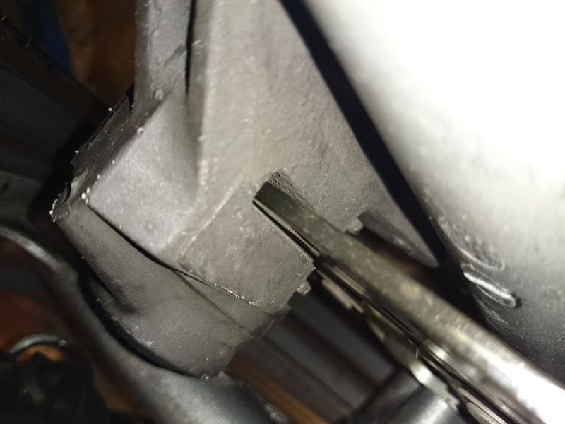

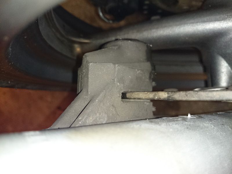

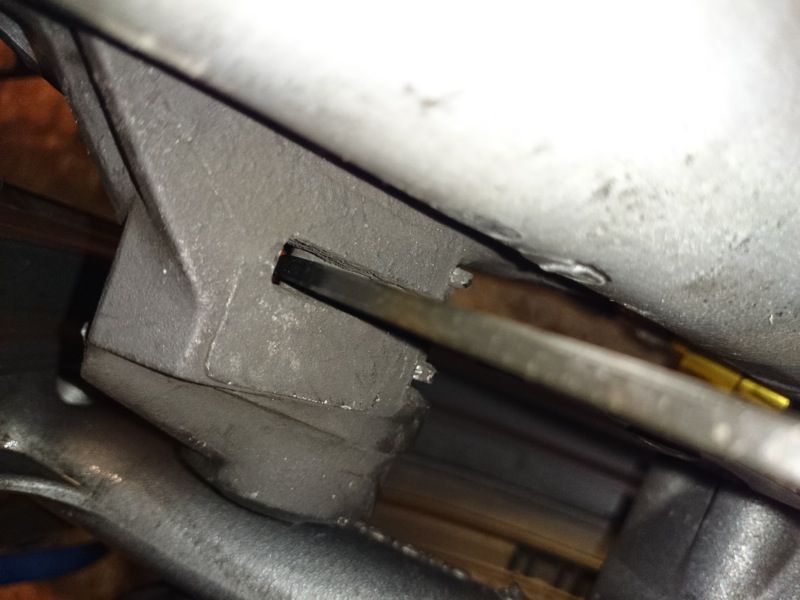

Pretty much,the forks slide straight in to your TRX yokes,but I found I need to put a washer between the calliper and mountings to line uo the disc with the centre line of the callipers.
Without the washer the disc rubbed on one side of the gap,
With a normal,M12 if I remember rightly, washer the disc and gap lined up nicely.
