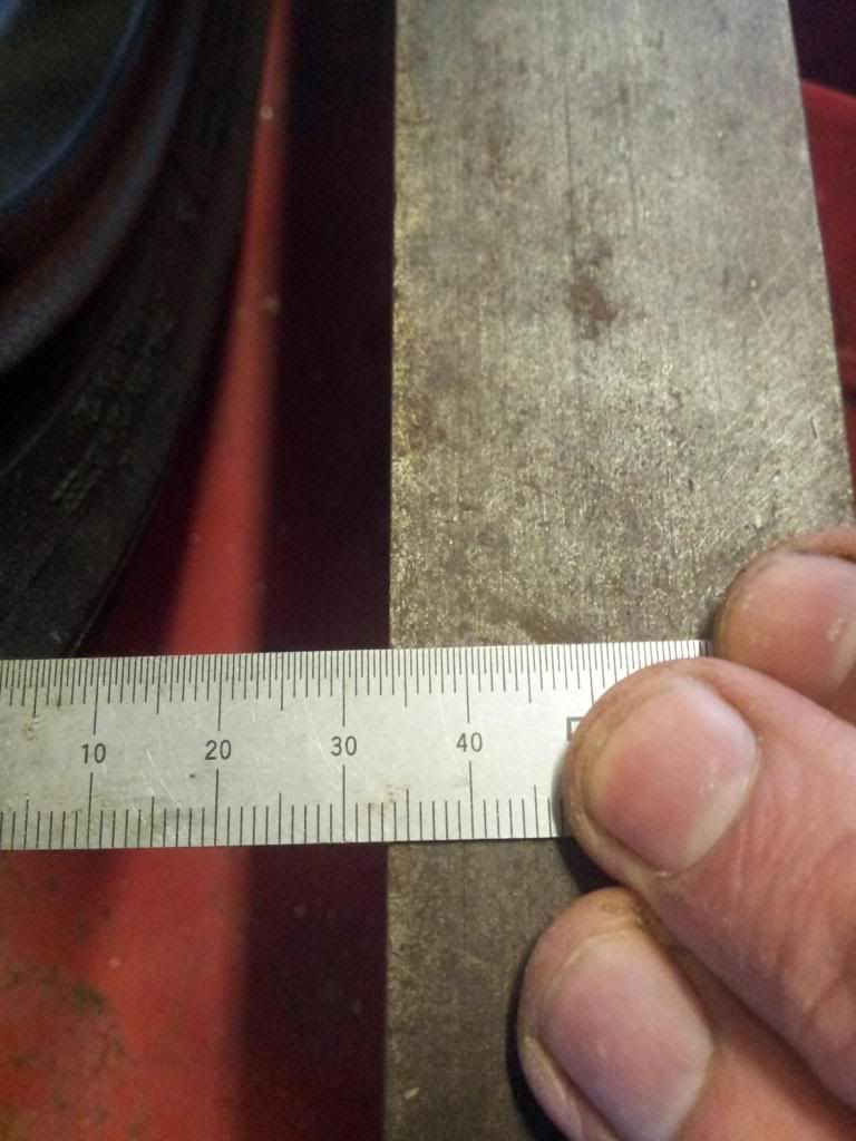

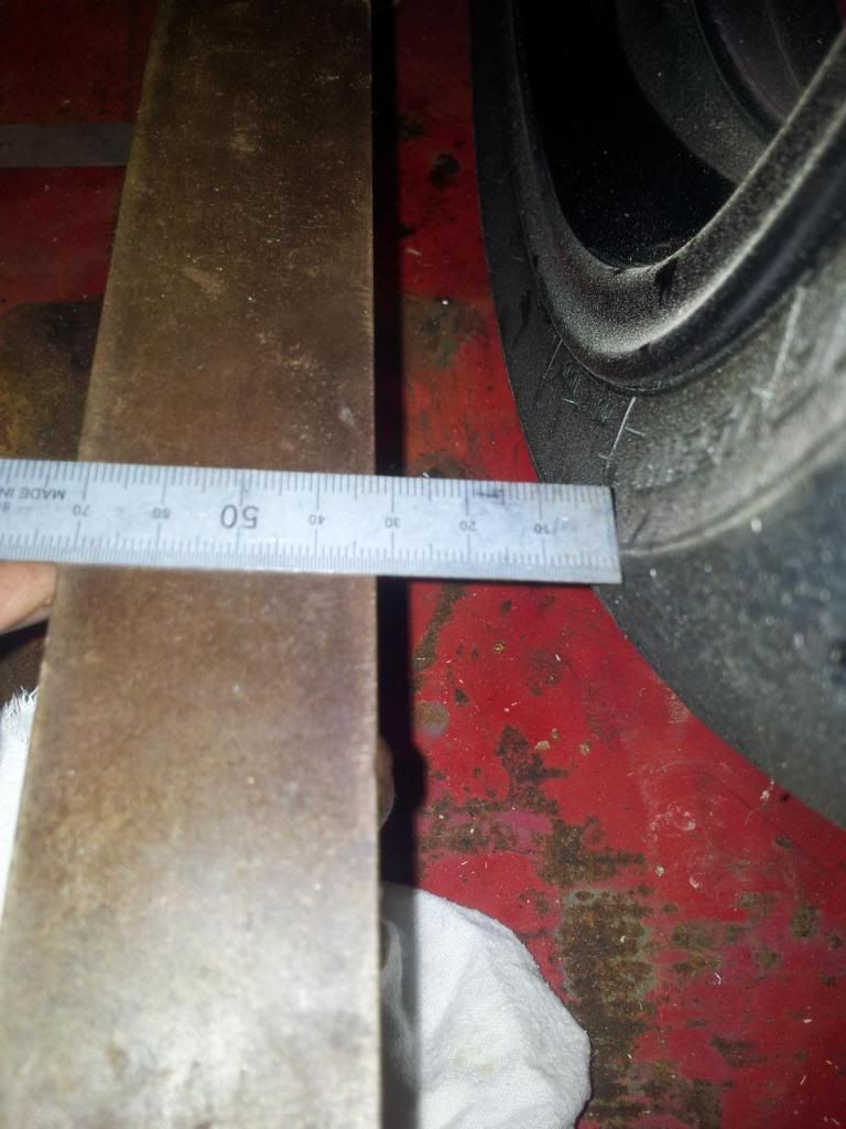

Yep, we have also done our measurements using an engineering straight edge Paul's was 32mm either side mine was 30mm either side (just different tyres used). When I return home I will post all the photos. Sprocket charge was £65.00 posted not cheap, but I have just purchased a new genuine chain guide at the cost of £75.00 so £64.00 is not that bad for a billet steel case hardened sprocket we also paid a local engeering company £20.00 each to have them machined down and now very happy with our results.

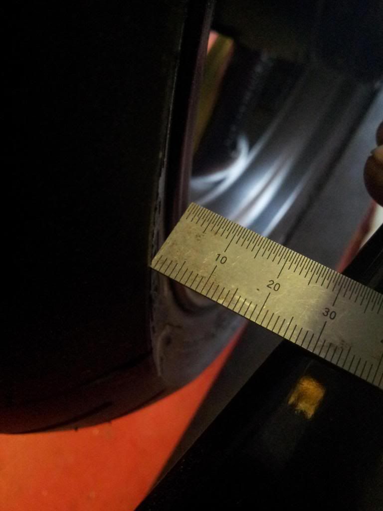

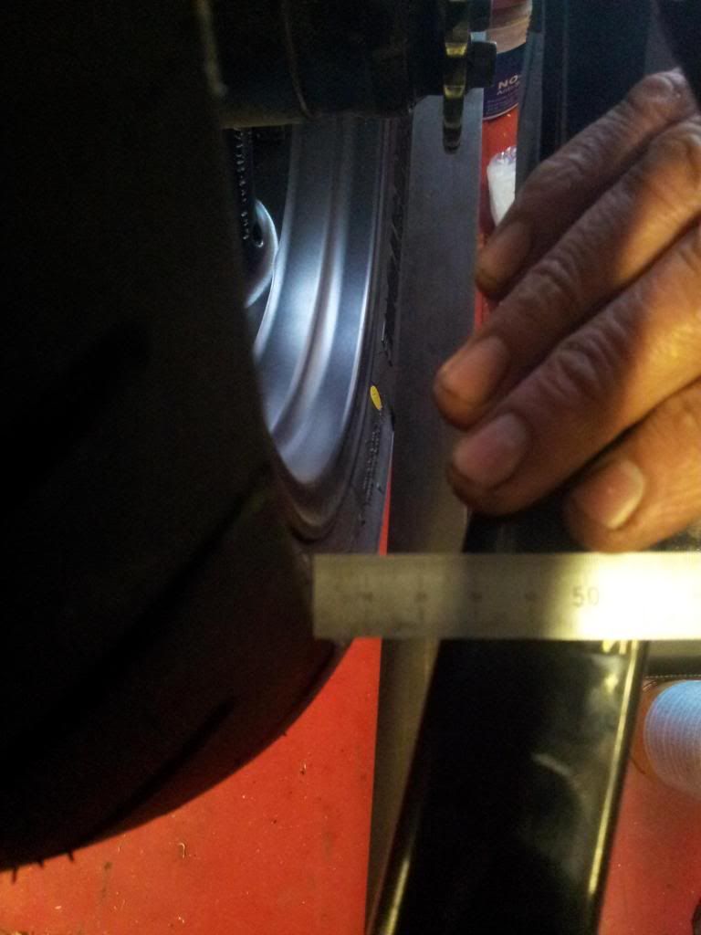

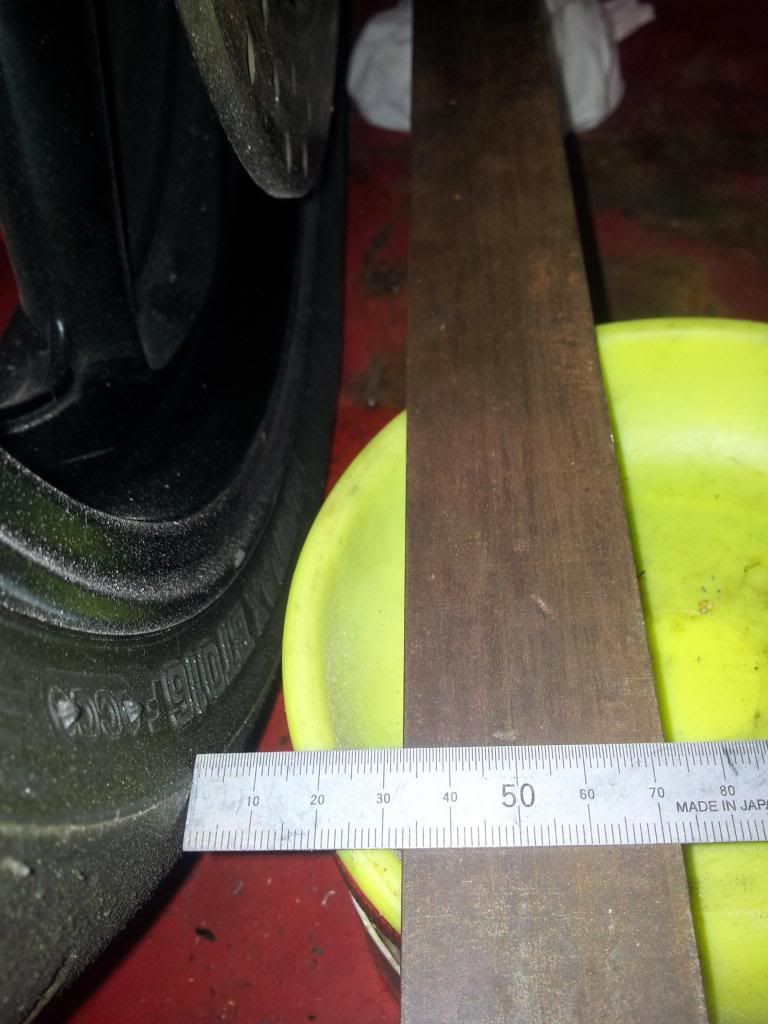

Yesterday Paul and my self re checked and checked again our wheel alignment, this is how we done the checks bike on rear paddock stand, chain off loosened back wheel off slightly moved the wheel as far back as it would go used a engineering straight edge measured the gap at the rear of the front wheel and then the front of the front wheel we got 33mm both sides
measured both sides of the front of the rear wheel we got 25mm so all square with our 6mm offset sprocket everything lines up perfectly. no need to hack any bits off your swingarm .
I sincerely hope this puts an end to all the doubting Thomas's.
