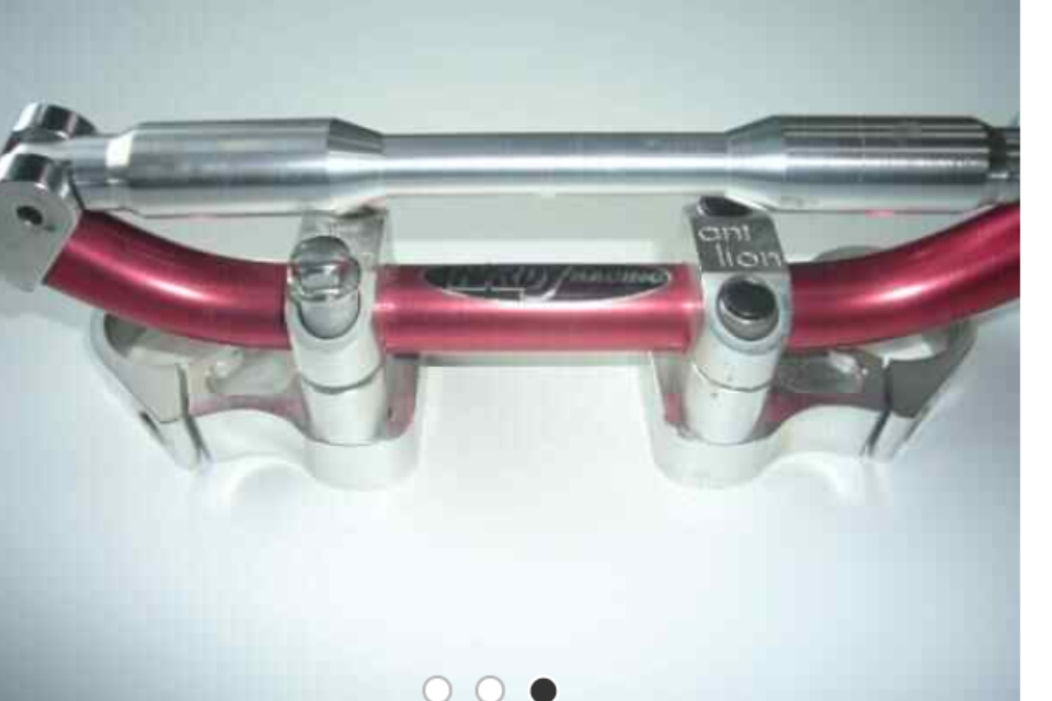

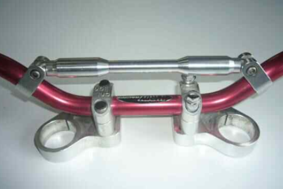

Here is something I got a hold of a few months ago and gave to Rod.
Great set up for what you are looking for as it allows for the bars to fit in multiple positions.
The piece that slip over the fork leg allows you to position the bars either forward or backwards and the actual handlebar riser mount bolt at the front and rear is held inplace in a slotted hole so it pivots to keep things square.
You can just see the edge of the slotted hole by the riser mount.
Take the photo to an engineering shop and they can whip something similar up out of billet alloy.
