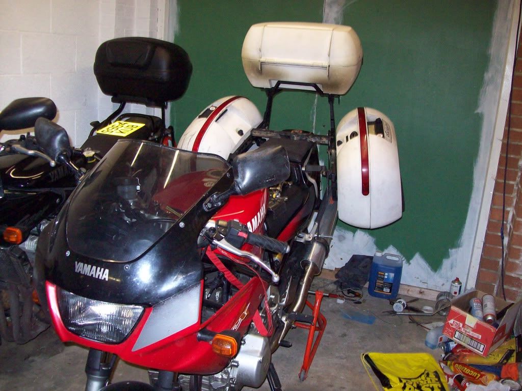

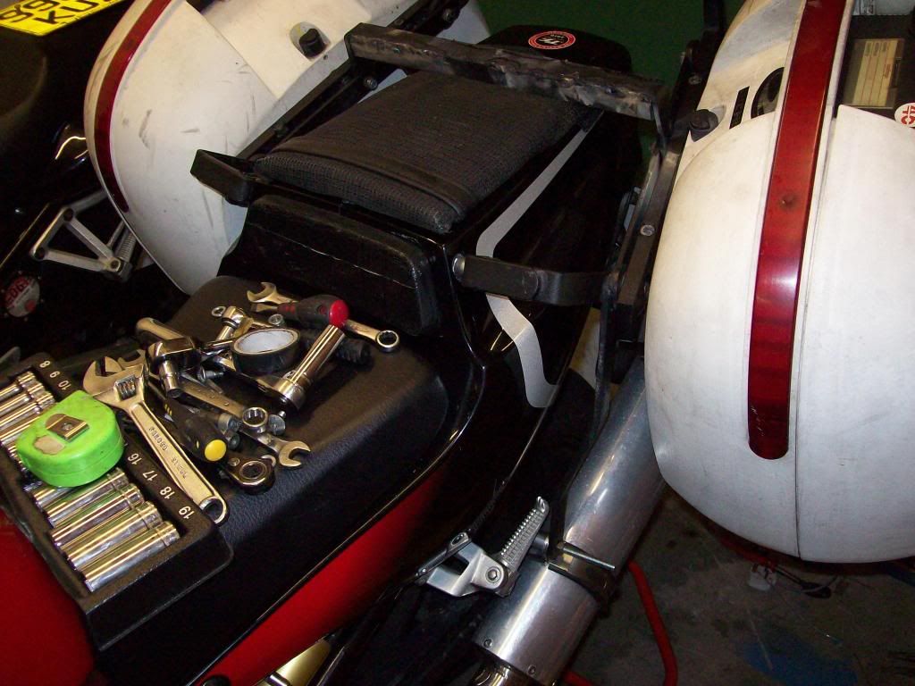

This was a bit of a crazy idea, which came into my head when we bought a full luggage kit for mrs peanuts fazer, I put the luggage frame from the fazer over the back of the TRX and thought, this isnt too far away from fitting. So my idea was, buy the cheapest set of full luggage I could get and make it fit the TRX, and its done, and very easily too.
The luggage was from an old cbr 1000. I put the frame over the rear end and found that the 2 side bars were millmeters away from the exhaust hangers. I bolted these to the hangers, and bolted another 2 u brackets into the side of the rear seat. I then got another big U bracket and welded that in the middle so all of the weight rests on the pillion seat. Over all it took less than a day and was pretty easy, but it does rule out carrying a pillion and access to the storage under the seat.

AAAAAARRRRRRGGGGGGHHHHHH.......... Burn my eyes out with a red hot needle, please :angryfire: :brutal01: :pukeright:

I think the term is `functional` but boy they is FUGLY. :shock:

yeah it is bloody ugly, the missus fazer looks quite nice with its luggage as its the same colour as the bike and I havent attacked it with my mig :D . But functional was the plan, and its going to be a lot nicer to ride to the TT with hard luggage, did it last year on the bandit with soft luggage and everything was moving around and I had to stop at one point to re-tie it all on after it started to hang off one side of the bike.

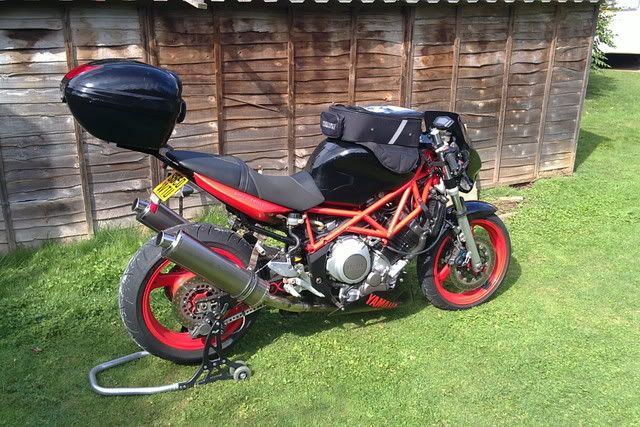

I stuck a top box on the back of the rex for the manx last year, thought mine was a quick job........

Is that a monster seat?

Na, speed triple

Hmmm looks really nice. =D>
