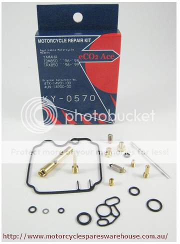

Here's a picture and a website (Australian) if that's any help:thhastrup wrote:Thanks, would that be a stage (ex. 1) kit og just a rebuild kit?
http://www.motorcyclespareswarehouse.co ... -parts-kit
