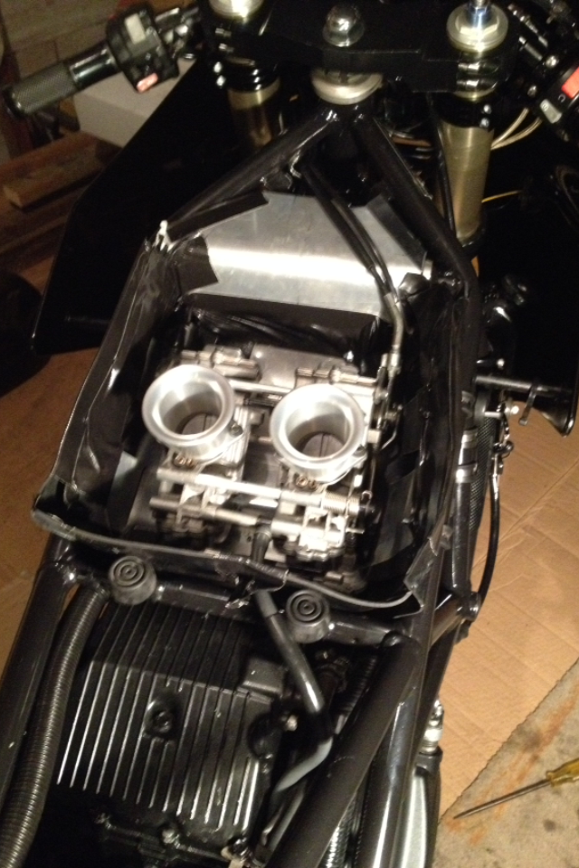

After working out the maths I made up my snorkel/ plate that works together with the bottom plate on the frame and come the dyno day organised in mid August for the forum members, I'll fit the snorkel plate in place on the tank and see how that influences things.
I may need a 2-3mm spacer to lift the tank but I'll leave the plate where it is at present as I can easily place a washer between the plate and tank mount to open the gap.
If no real gains on the dyno result compared to my reference run , I'll remove the front tank bolts and simply lift the tank 2-3mm for another run to see if a little more gap influences velocity and my torque dip.
That gives me a couple of weeks to tidy up the edges on the tank plate and look at options of making a mould of the airbox if all work out well.

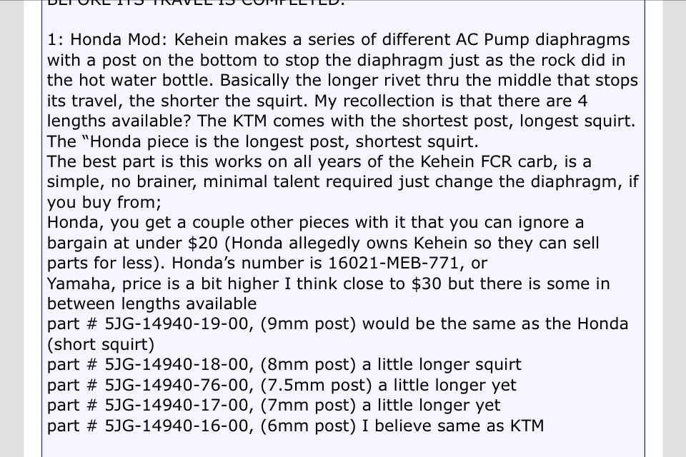

I took the carbies off today to do a couple of mods to the airbox I made and I noticed the ACC pump shot fuel for around 3 seconds after twisting the throttle....
Mm M I think I'm onto something here and this confirmed my suspicions.... 8) 8)
I love the Internet... I knew the squirt duration seemed long... 3 seconds from when you stop twisting the throttle and here is the way around this thanks to the link I'll place up shortly but here is the info with part numbers to change the diaphragm rubber with longer stopper length/ shorter duration..
Be mindful this may not suit all TRX's with FCR's and the 3 sec shot would prob suit most std / fcr TRX's .. You do day to day commuting and std pistons you may run the risk of leaner mixture and detonation.

Price from Yamaha $48
Honda. $54.65
http://www.allthingsmoto.com/forums/f-1 ... 1-a-33841/

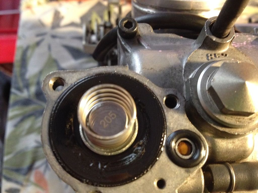

Post by cobbadiggabuddyblooo » Thu Aug 04, 2016 9:51 am
Pulled the ACC pump apart today and the diaphram has 055 printed on it.. Good chance this coding is 5.5mm which is why the 3 second + shot of fuel.
So to determine the best timing I placed different cam shims to check timing and got myself to just over 8mm with about 1 second shot at WOT.
Riding under 3500rpm your only using upto half throttle and plenty of pump fuel flow to deal with the lack of vacuum and extra air when twisting the throttle. Cranking it further to full above 1/2 throttle the shot taper back to between 1 -1.5 seconds and there's enough vacuum as the revs rise to draw the homogeneous air/fuel up the needle.

I have to be mindful that the more shims Inplace also takes volume away inside the pump bowl too.
I tried the o ring mod on the ACC pump and found throttle response suffered under 3000rpm and would drop down to low 11's and flood for a second. The O ring mod gives more volume of fuel instantaneously when you twist the throttle . So a bit of a trade off in loose a little initial throttle response which leaves a little less fuel in the bowl and made slight gains in A/F at 5500rpm.
So fingers xxx I can find that happy medium with just the 1 X 2.45mm shim in place, keep my initial response and A/F at 12.5 -13 through the rev range...
A little more research ...
I put fcr pump diaphram into my search on eBay and just like it's mentioned in the link above, the KTM's run exactly the same 055 diaphram. There was other's listed to for various Yamahas 7.5mm and Hondas 9mm and you could clearly see the difference in height on the centre rivet/post.
But why buy a new diaphram when a shim does exactly the same thing. It can not go anywhere because it's contained in amoungst the compressed Spring ... But remember you have to factor in a little less overall capacity in the pump bowl like a larger leak jet would do.
