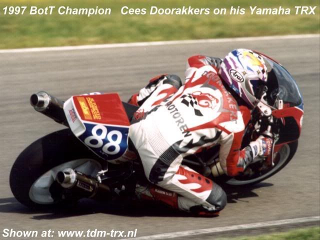

Post by CULater » Mon Sep 10, 2007 9:15 pm
We have several members who race (or raced) their TRX (and TDM)
The engine don't like reving over 10.000 tpm.
It also break down when the balance shafts are removed.
The BotT (Battle of the Twins) championship winning TRX back in '97 had 105 Bhp. (had lots over OVER parts in it and was blueprinted by a Yamaha technician) It lasted the complete season, the
biggest problem they had during the season were the rearaxle bearings
they couldn't handle the power.
