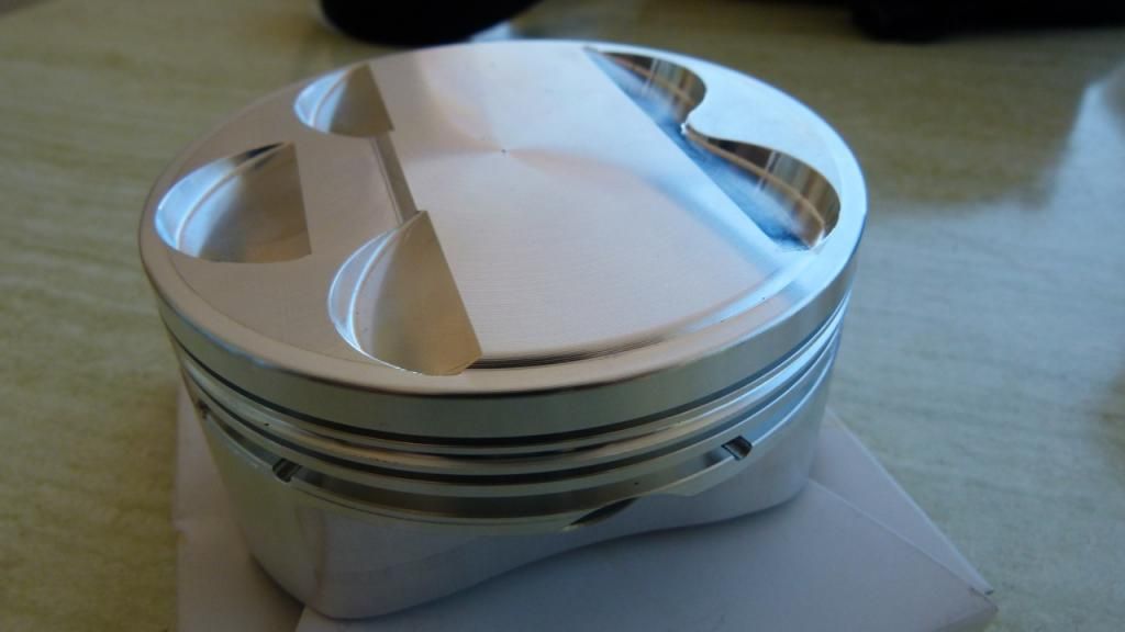

The weight saving on the pin is due to being shorter and chamfered on each end with the thickest part being where the con rod runs and upon the inside edge of the pin boss.
Close up shots will show the weight saving on the pin boss which also has been tapered with the thickest part on the inside by the Conrod .
I'll post some close up hi def photos shortly showing the beautiful engineering of these pistons.
They are balanced too ( notice the underneath shot and the small divet machined to balance against the extra valve relief for the inlet) and all edges have been rounded .
Just look at the exhaust valve reliefs and the rounded finish between the cut outs to aid flow .
The close up photos I took today of the valve reliefs will show the finished edges.

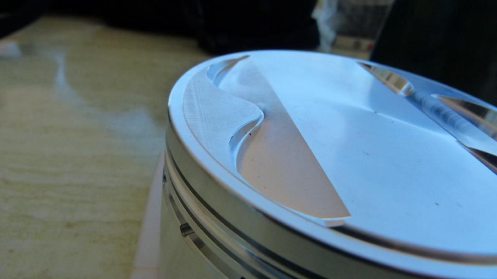

Here you can see where material has been machined off the pin boss to support the use of a shorter pin. Notice how close to the conrod extra material has been left for strength and support.
By the oil ring land you can see how it has been machined to capture the oil from the bore to feed it under the piston for cooling.
Oil it fed to the pin from the oil scaper rings and has a groove machined around inside the pin boss for distribution all around the pin.
The I.D. of the pin is tapered for weight loss but strength is still retained close to the inside edge of the pin boss and small end on the con rod. This compliments the extra material left on the inside of the pin boss seen on the 1st photo.
You can see where the exhaust underside of the skirt has been machined and material removed in the small divot to counteract and balance the piston with the extra valve pocket for the inlet side.
Re: 878 ARIAS 12:1 SLIPPER SKIRT PISTONS on offer
You can see the shaping on the valve relief to aid in flow by soft contouring the valve relief.All the edges after machining have been de-burred and the flat top nature of the piston.

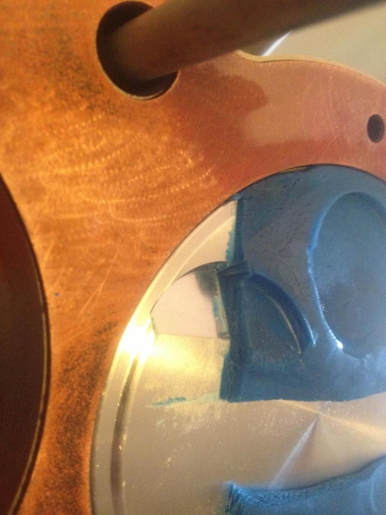

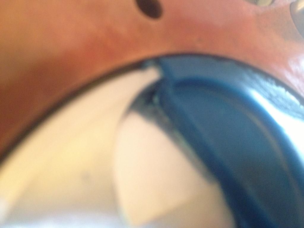

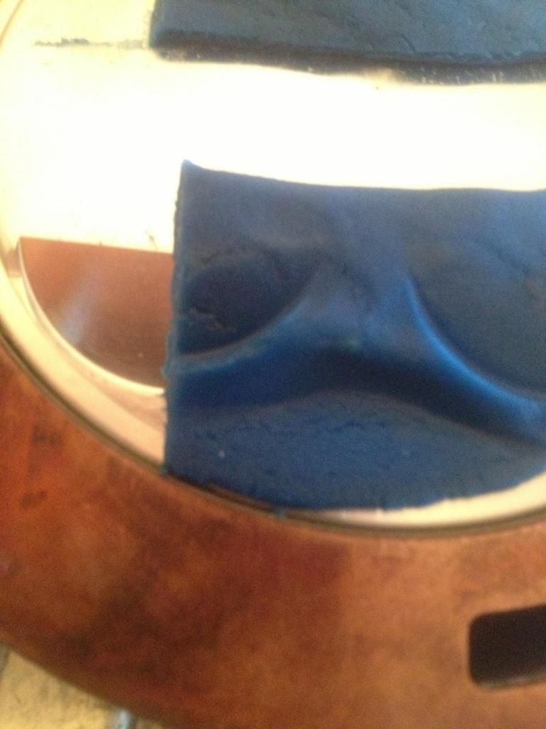

Dry run completed today with a pair of Arias piston using my head with the 1mm oversize valves.
Using a 0.9mm copper head gasket, I feel confident enough I'll have the clearance to run this 1mm oversize set up with no extra fly cuts to the valve reliefs.
Squish was 1.5mm well above the minimum set at 1mm by Arias.

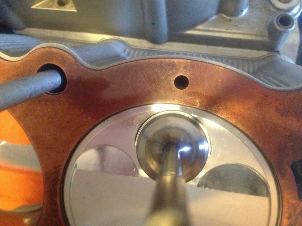

The photo below shows an Arias piston with a 2mm oversize valve sitting central to the valve relief with approx.1mm clearance.
Last edited by cobbadiggabuddyblooo on Thu Nov 05, 2015 2:47 pm, edited 1 time in total.
The std valves have enough clearance .
You need around (1.5mm) inlet and 0.100" (1.5mm) exhaust clearance to the top of the piston.
But depth is not the issue , radial width is if using the 2mm oversize valves is at minimum spec.
But this is something you will need to check yourself.
