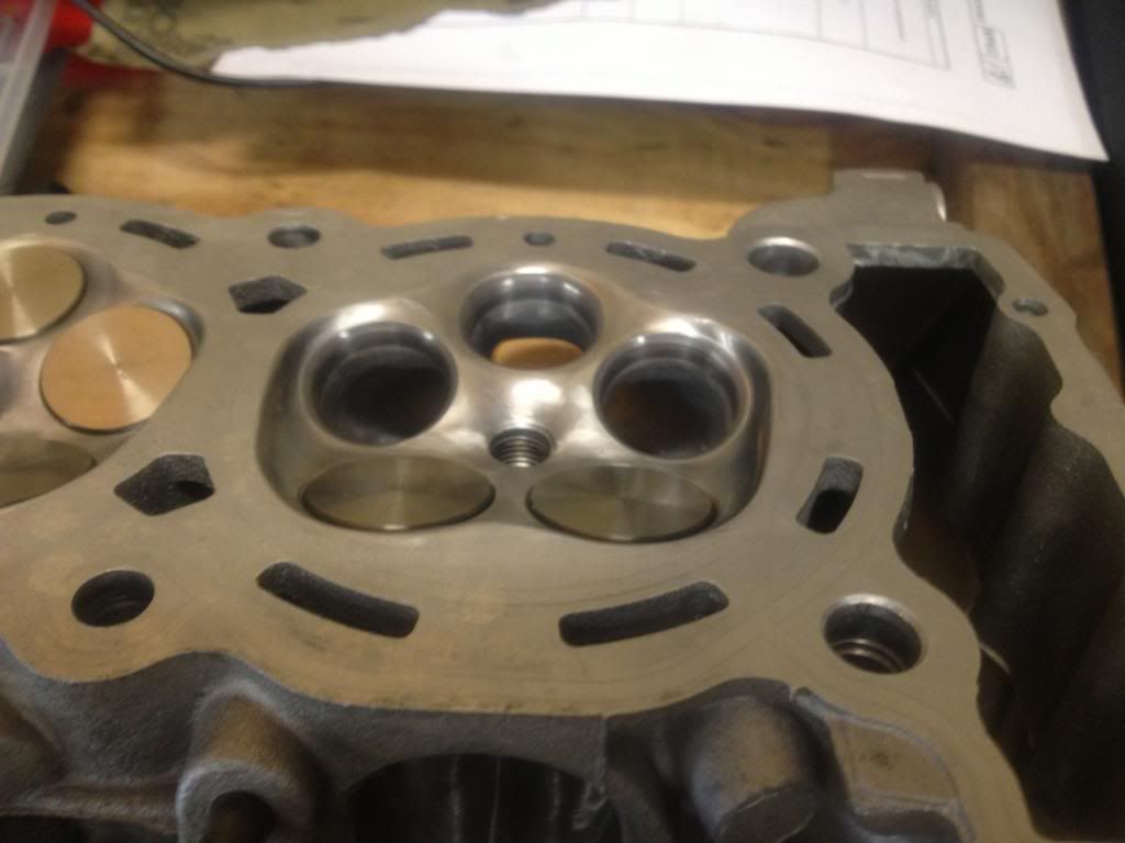

Post by cobbadiggabuddyblooo » Mon May 26, 2014 11:58 am

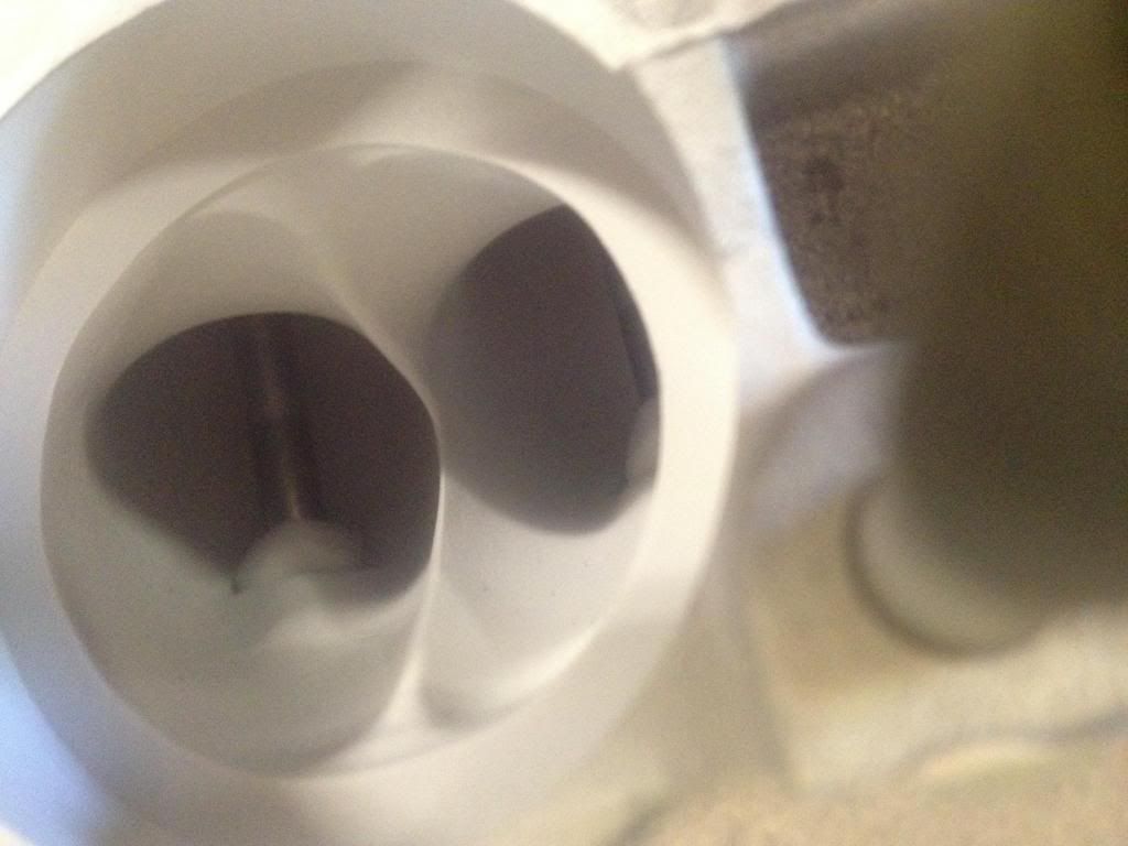

And again the advantages of ceramic coating with the exhaust ports coated to deal with that extra heat contained within the combustion chamber once expelled allowing for the heat to travel straight out though to the exhaust headers and onwards keeping things cooler around the chamber and limiting absorption by the head itself
Image.
All was flowed with the intake manifolds inplace and matched to the FCR41's
Next on the hit list is to take the barrels to be bored and drop the head back to have all the valve springs and Kent Cams fitted back in place.
In the mean time I'm off to get some copper head gaskets produced for the TRX850 so if ever the bike needs to have the head removed, it's just a matter of re annealing the gasket and reusing it once again so eliminating extra costs.
I figured I can get them manufactured for around the same price as a OEM Yamaha gasket.
Other obvious advantages with the copper head gasket being it's strength.

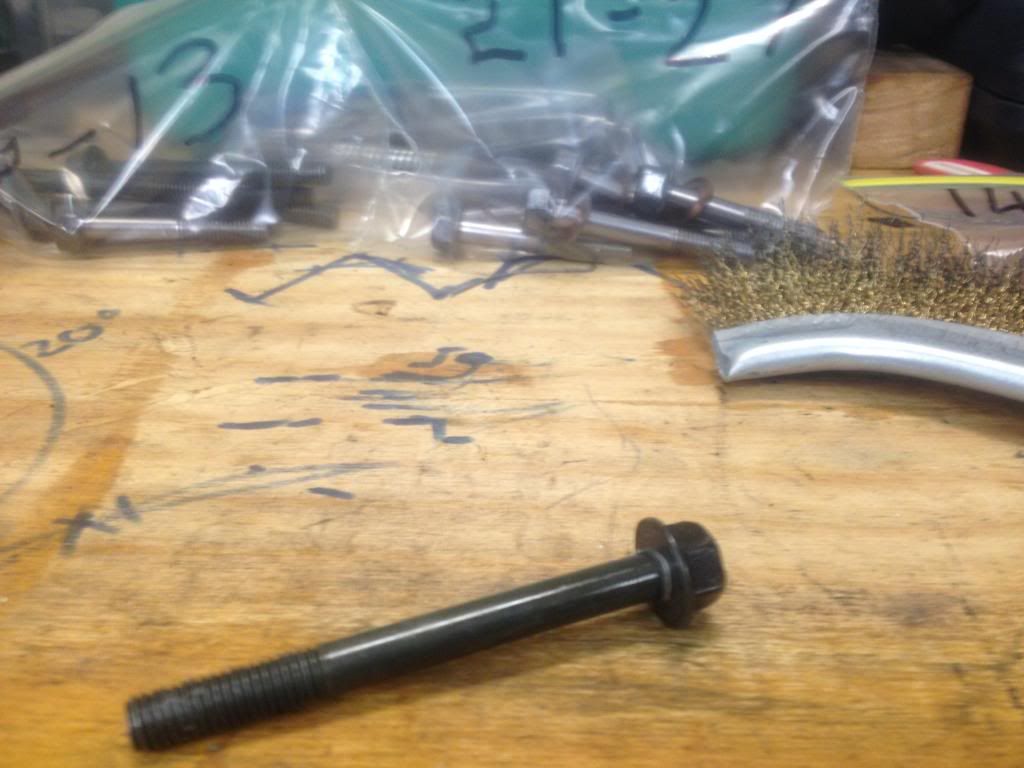

Busy day yesterday, cleaning all the bolts that hold the upper and lower crank cases together.
Wire brush and kero bath and quickly run the die over them so all nice and clean, just like the threads in the case themselves which I had run a tap through a couple of weeks ago.
All clean, new main bearings and time to place the crank into the upturned top half and then place another 3 pieces of plastiguage on the crank before bolting it all together.
The 6 main m10 bolts torqued up around the crank then started on the other 20 odd bolts around the outer edges of the case .

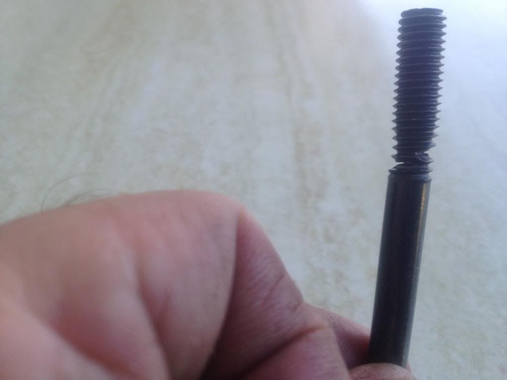

Started on one of the smaller m8 bolts and thought to myself :-k this doesn't feel right but lets just give it a touch more and CRACK :shock: :shock:
Straight away I took the torque wrench off the bolt and put the ratchet on to loosen it off. [-o< [-o< 8-[
and to my surprise it loosened off and screwed out. :thumbright:
Thank god I had cleaned all the threads out as any gunk in there and things would have easily gotten stuck and just sheared the bolt right in half.Image
So now I will not take any chances and I'll replace all the bolts..
I can only surmise after seeing all the silicone used between the cases on a previous rebuild by someone,there may be a good chance all the smaller M8 where just done up with a socket as the torque spec is 4nm under most torque wrench ranges and you need a smaller nm/ inch pound torque wrench which not every joe blow has.
The smaller m6 bolts are even down at the lower end of the inch pound range on my torque wrench but it just drives home the fact these torque specs are placed there for a reason.
The young fellow who bouht a head off me a couple of months ago had suffered a similar fate by over tightening the cam caps. #-o and again the trx I looked at last week locally here on gumtree had done exactly the same thing with the cams locking up in the head.
Well least the engine number is still original on the bike as not much else is now :lol: :lol: :lol: :lol:
