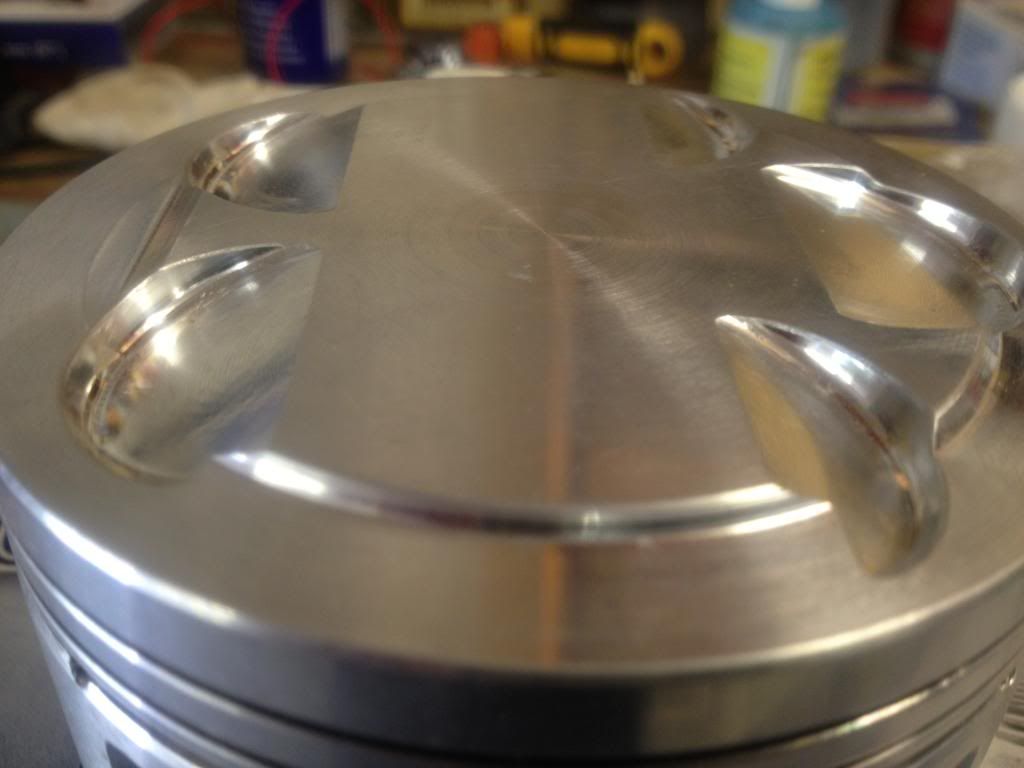

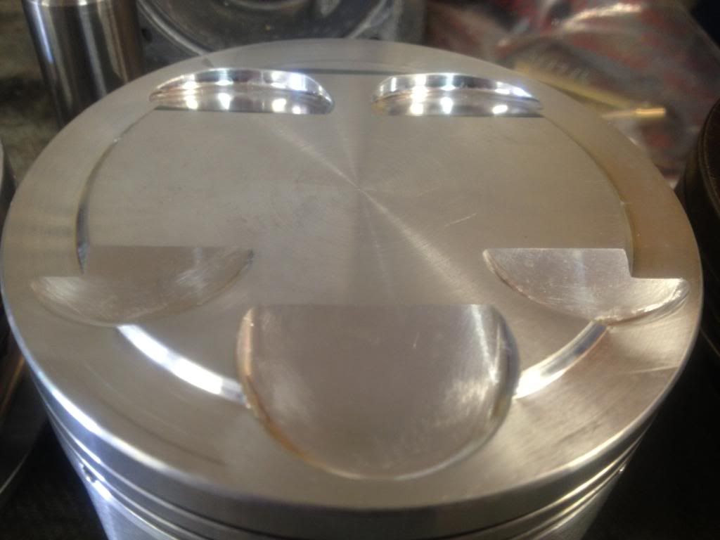

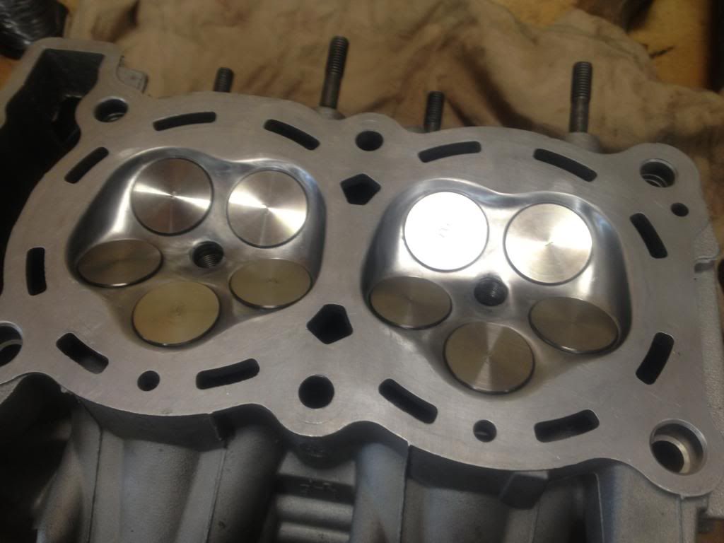

Picked up the head today..
and dropped the crank,rods and pistons off to have the piston valve cut out taken out 1 mm to accommodate the larger valves.
I chose the Ross pistons as they are a 12:1 forged relief piston and a similar design as the std Yamaha piston.
They have a raised flat top and not domed like the JE pistons which should aid in the how the flame front manages to burn the fuel and swirl the fuel on intake and quench.
They also use the OEM 1mm oversize Yamaha rings and use the same principal to deal with piston rock with a concave shaped ring to keep a constant seal as opposed to the JE which has a wider ring gap and the rock is taken up by movement of the piston rocking in between the wider gap.
Both piston designs are the same using the oil scraper ring to feed oil onto the pin and under the piston for cooling.
They also have less weight and less surface friction area compared to a full skirt J.E. design.
This explanation basicly sums up most on the choice between the Ross and J.E. piston
There is nothing wrong with the J.E.878 piston but there is better and J.E. also make a similar designed forged relief piston but no readily available for a trx unless it's a special order.
With the std OEM 849Yamaha piston...870 Ross piston and the JE 878
You can see the quench area on the Ross is a little wider to aid in cooling.
And the JE pistons for a comparison

Maybe I missed something, BUT......
If the valve is 1mm oversize in diameter, the piston valve cutout would be getting recessed only an extra half a millimetre, right?
I'm sure you got it sussed, but thought it better to post and remove all doubt.
Gordo-
- Rod.s
- Posts: 1406
- Joined: Sun Apr 25, 2010 11:01 am
Not recessed, but the cutout diameter increased by 1mmGordo wrote:![]()
Gordo-

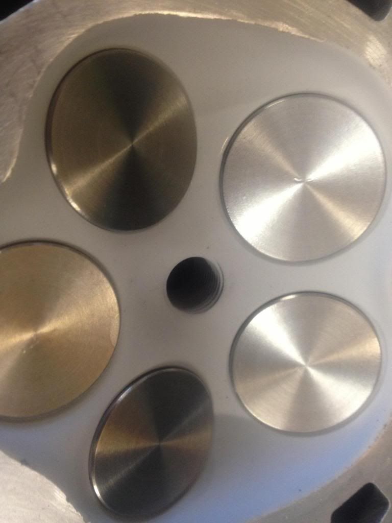

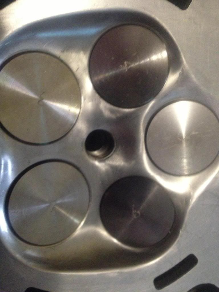

Bit of an update on how things are progressing.
Crank pistons and rods balanced and valve cut outs have been taken out to accommodate the larger valves. Finished in 5 days..
I like the sounds of things when he said this should spin up a little faster giving me a little more out of the corners..
Got a call this morning too the pistons,valves and head ceramic coating is completed and ready to be picked up.
Done in 2 days..
Early next week I'll post up a few photos of before and after ceramic coating on the pistons and valves,chamber and exhaust ports plus photos / specs on the balancing .
Next week it's on the final phase of just having barrels bored, then everything cc'ed to give me my 12:1 compression ratio back and a thickness so I may get copper head gasket made to suit.
I'll get a couple of extras made at the same time and will work out cheaper than one from Yamaha.
Good thing about them is they will be reusable so if ever have to pull the head off again ,just anneal and use again saving you nearly $100.
I should have the cush drive rubbers made up to suit the dymag wheels too with a number of spares and last wheel spacer machined to suit the front Carrozzeria and new wheel bearings fitted..

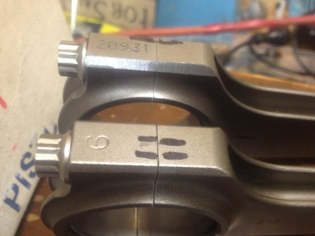

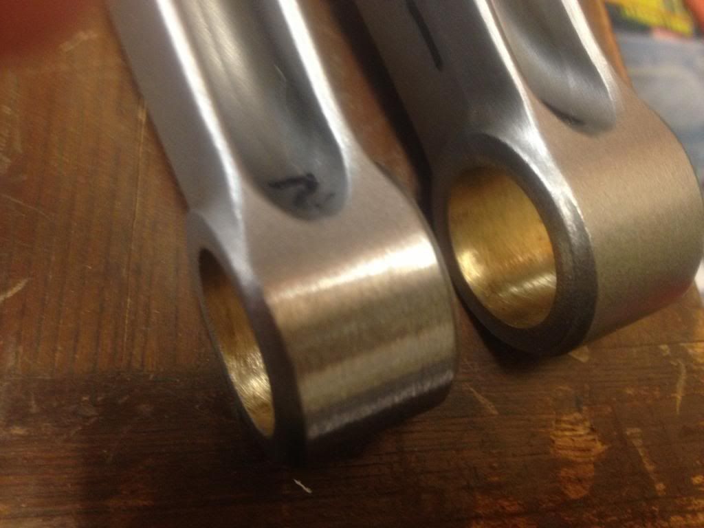

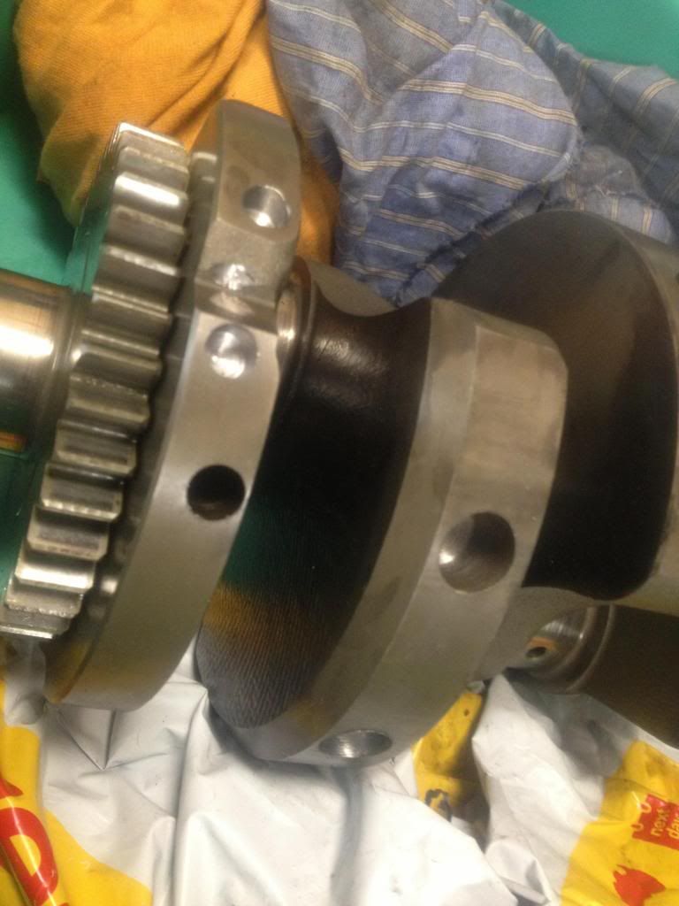

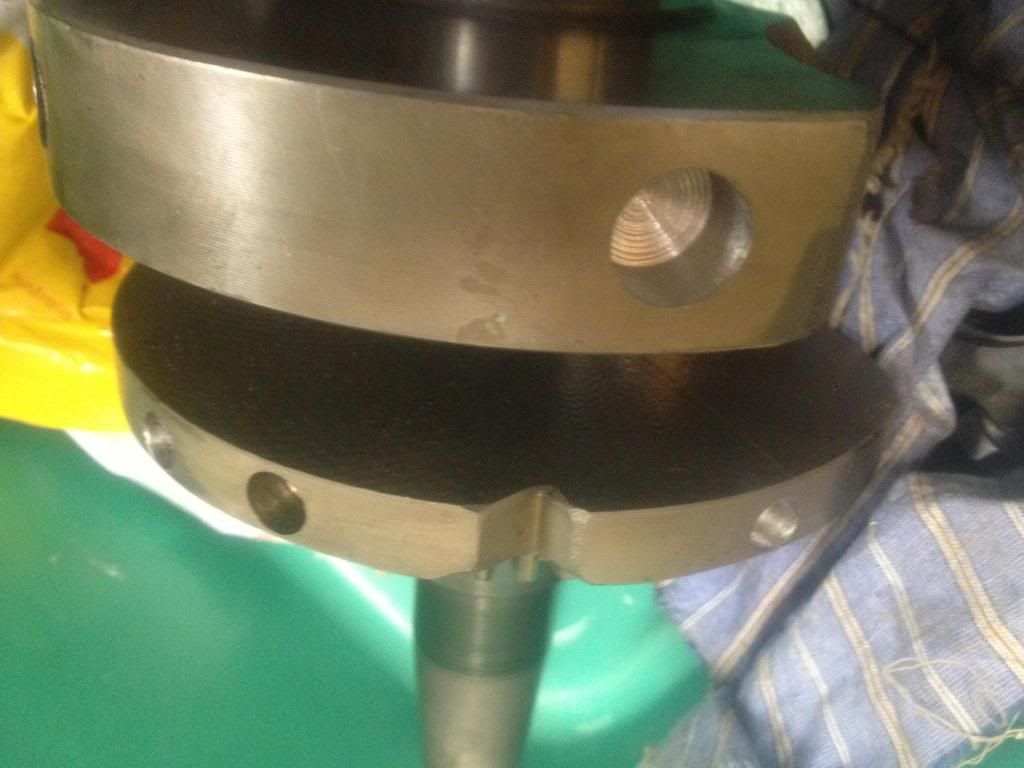

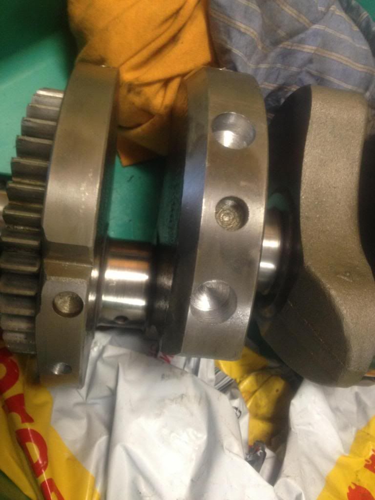

Crank, rods and pistons all balanced up and Grant from Brisbane Engine Balancing has managed to get it all within 0.4 gram. With the Ross pistons only being a few grams heavier than the std TRX pistons to start and only need to shave a poofteenth off to get to where he needed.
STD piston/pin coming in at 409grams and 422grams for the Ross pistons/ Syd pin after having the valve relief fly cut for the 1mm larger valves.
With the Carrillo rods being a lighter item by around 68grams than the std rods a little weight was taken off the crank weight as you can see by the 3 holes into the crank weight.
One thing I did was label the pistons,pins and rods to make sure each and every item goes straight back to the same position.
One thing I noticed straight away was a little weight taken off the base of No1 Carrillo rod and a light shave from the top of Rod no2. and 0.8grams difference between the pins so while at Competition Coating to get parts ceramic coated,he gladly marked each piston/pin with a reference so again hopefully making things idiot proof.

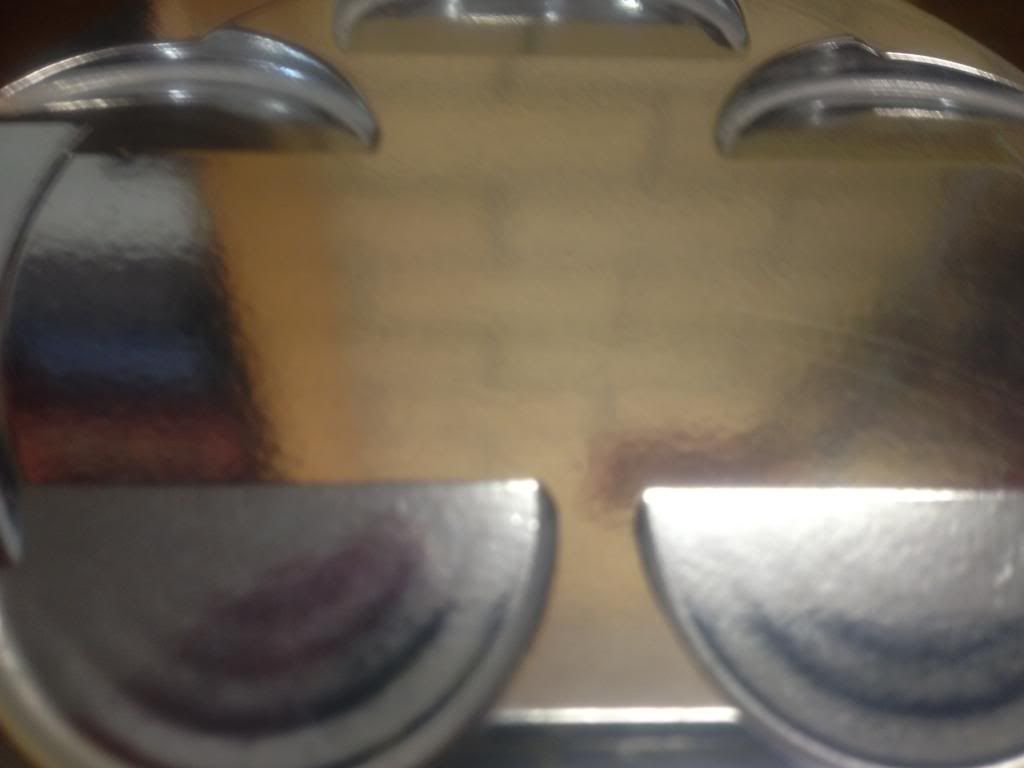

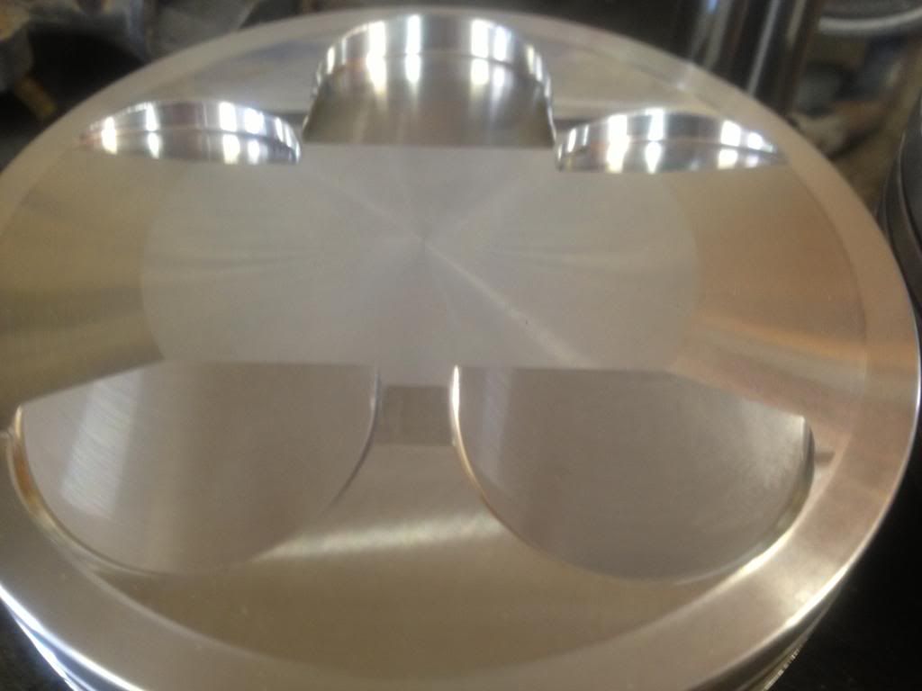

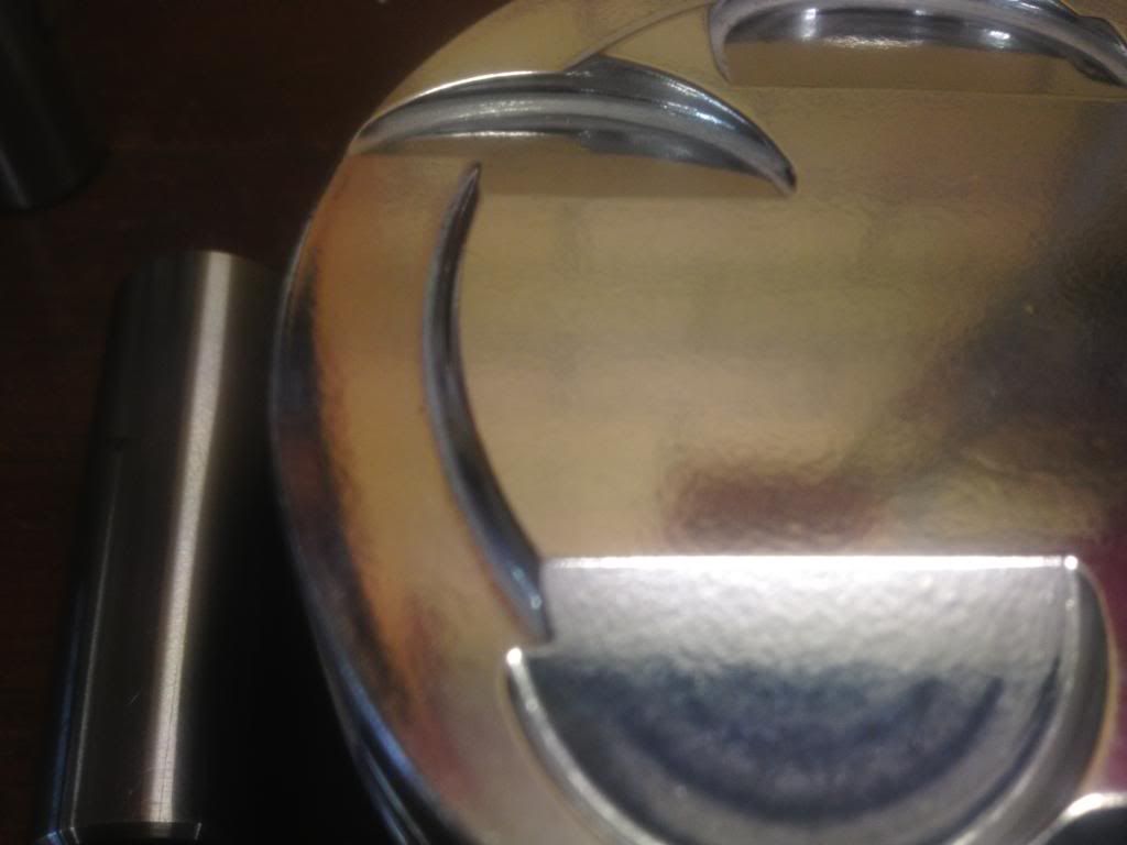

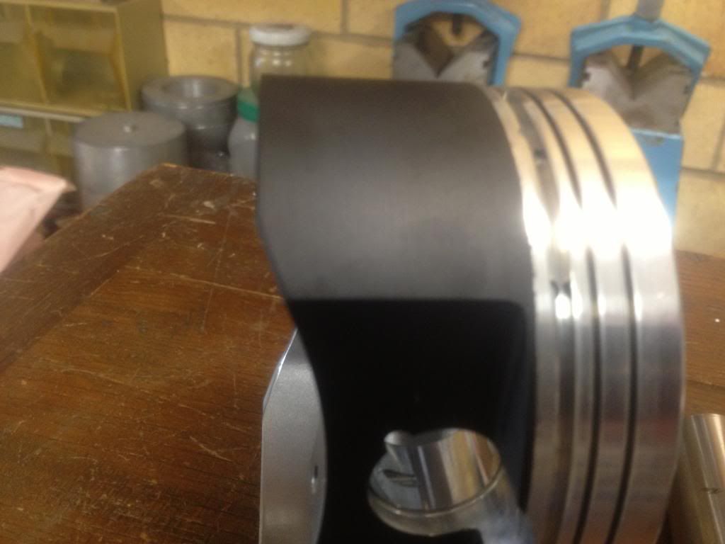

So here we have the pistons with a before and after shot of the work done.
Here you can see the slight graining of the ceramic coat on the piston crown.
The advantage of coating pistons with BOTH Ceramic Thermal Barrier and Dry Film friction reducing coatings are:
Pistons are the engines weakest link when it comes to heat. How often will you read of competitors dropping out of races because of burned pistons. All good engine builders know that tunig an engine for “optimum leanâ€, maximizes horsepower by generating more heat in the combustion chamber. However, if too lean a mixture is run, pistons will be heat damaged (black death, skirt scuffing, “holed†pistons or missing top ring gland). Oxygen and fuel is spark ignited under compression to generate heat. The heat causes gaseous products of combustion to expand rapidly, forcing the piston downwards for the power stroke. Generating more heat causes more gas volume expansion (more H.P) but can also melt or burn aluminum pistons. Leaning down the air-fuel mixture to where oxygen is proportionally too high can cause metal to be burned away (oxidized), just like an oxy-acetylene cutting torch. Competition Coatings Ceramic Thermal Barrier will insulate from excessive heat and effectively protect from oxidation.
And thanks to Paul for with a little ceramic magic has labelled each piston to a specific pin.

After 11 months I finally got the head back from being ported and flowed and again thanks to Jeff Chesterton for a little of his artwork.
John while putting this all together for me has once again numbered each valve so when they have been removed for ceramic coating they can be placed back to exactly the seat they where cut for.
The advantages of coating a valve is to extend the part life and to reduce friction.
INTAKE valve seals the combustion chamber on the intake port side of the head, prior to that it is opening to allow air and fuel to enter the combustion chamber. Intake valves usually do not suffer as severely as exhaust valves which see combustion chamber temperatures. Therefore, the primary concern is lubricating the valve stem and seat. We do this by the application of a dry film lubricant. This reduces the friction particularly in engines where oil flow is restricted to the head. the dry film takes over the bulk of the lubrication chore. It is still advisable to coat the face of the valve in the combustion chamber to help retain combustion chamber heat in the combustion chamber. This also reduces the temperature of the back of the valve so that the incoming air/fuel mixture does not pick up as much heat from the valve, as it would, if is were not coated. Normally it is not necessary to thermal barrier coat the back of the valve, though it can be done if you wish.
EXHAUST valves experience a more severe environment because the valve is seeing combustion chamber temperatures, which on a normally aspirated engine can easily reach 730 degrees Celsius. So the face of the valve definitely gets a thermal barrier coating to reduce the amount of heat the valve will absorb. The back of the stem is coated with dry film lubricant. Again this is critical on the exhaust valve stem because the heat can reduce the ability of your oil to lubricate. Consequently the permanently bonded, high pressure, high temperature lubricants work extremely well at reducing friction and wear on the valve and the guide. In some cases, it is advisable to coat the back of the exhaust valve (such as with titanium valves where metal erosion can occur due to hot gas and flame passing over the valve). On other valves it is still preferable to coat the back with a dry film to contribute to the carbon shedding so a build up of carbon does not occur on the back of the valve which can create turbulence in the exhaust flow.
By coating the back of both intake and exhaust valves after all machining work is done you permanently bond the lubricant to the areas that will contact the valve seat thus reducing wear in this area and creating a better long term seal.
