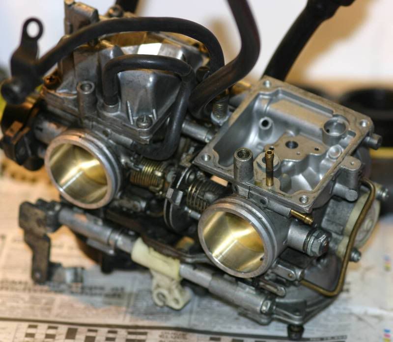

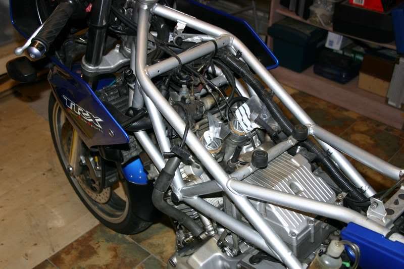

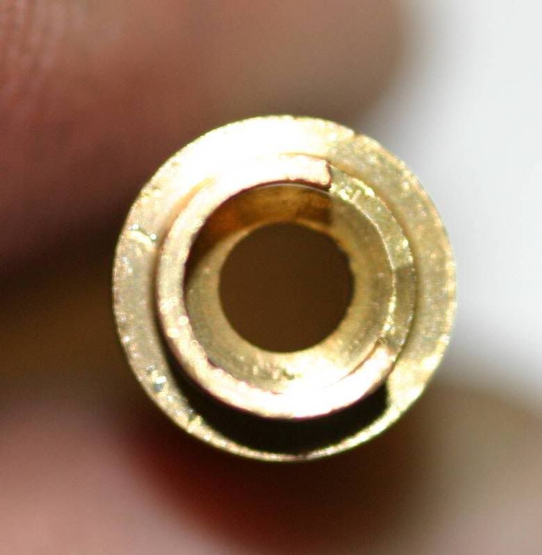

Well folks, I've took the carbs off and had a look at the emulsion tubes and they dont appear to be ovalled to me..take a look and pass comment please! the needles seemd fine as well. A few of you (DFH and youngy) have mentioned intake clearances so I guess I'll have to look at that next. Though I'll probably check the chokes first and make sure they're closing properly like TWOLFE said.
Question; what are my chances of rebuilding the carbs successfully with the old seals/gaskets? I dont fancy waiting days for new ones. Any thoughts?
Carbs off
Carbs:
Emuslion tube?;
Doesn't look ovalled to me. The picture is deceptive, it's definitely not obviously "ovalled";

maybe it's the photo but that emulsion tube doesn't look great to me.
old seals/gaskets = no problem. while it's in bits check your float heights. choke is possible, but as the problem has switched sides I'd say unlikely.

Thanks youngy. Maybe the tube's not perfect, but there's a dark coloured area (varnish?) at the edge of the bore (to the right of the bore in that last picture) which tends to make it look out of shape, but when you're actually holding it and looking at it it seems pretty much circular. At one point in my original post I asked how obvious is it when the tube is ovalled and someone said its very obvious. Thats why I put this picture on, for people to compare. Any one got any pics of a worn out tube?
Yes; I may aswell check the float heights while I'm at it. I agree about the chokes now that you mention it. They both appear to be returning anyway, although the mechanism is a little sticky now. I'll give it a good clean.

when i removed my tubes they also did not seem to bad ,,,but when i put new one's in there from factory pro it made a huge difference ,,,yours do look feked to me
Re: Definitely not emulsion tubes then?
Post by slow codger » Thu Mar 27, 2008 5:56 pm
:? As above, they dont look round!

OK OK!! Where's the best place to get tubes? £80 a pair for Factory Pro from straightline racing in the UK. £37 a pair delivered direct from Factory pro in the US. £30 a pair delivered from Kedo in Germany. Dont know if the ones from Kedo are nickel plated like factory pro's though. Any other sources?

factory pro will be harder wearing as they are plated,,,do the needles as well , i used yamaha ones

Yes, that was my thinking. The factory pro ones are nickel plated. I've ordered a pair. I was going to use the standard needles. The plated tubes will probably wear out the needles now!! But I'll take a chance.
