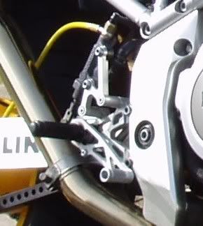

Well, as the title might suggest I am curious about the benefits of changing the rearsets. I understand that they move the pegs up and back, and presume that this is to improve corner clearance. Is there anything else I'm missing? I have checked earlier posts and it seems a few (not many) people make them for the trx and some of you have them on your rides. For those of you that do, would you care to share your experience with them in terms of riding/cornering? Also, in terms of daily riding, are they a bit too extreme or do you find them comfortable enough?

Rearsets aren't just about raising the peg height - some will offer more room that stock.
For me, I wanted more corner clearance and my pegs are up and back about 30mm. I regard my peg and bar position as fairly extreme (certainly compared with stock) but can still do 600 miles in a day - although I ache like hell the next day.

I'm running a set of LSL rearsets which move the pegs back about 20-25mm and up about 20-25mm.
As the TRX standard riding position is quite relaxed, this new position doesn't cause any concern or discomfort for me at 6' 1".
I found that the standard position made me sit right forwards, and heavy braking had me squashing the wifes wedding present on the tank!
so biggest advantage of them was to make me sit further back in the seat.
Ground clearance is better, but I never grounded the standard pegs anyway, even on track.
Plus I got them cos they were cheap and second hand, and look good!

I've got the Coerce brand rearsets on my road bike and track bike. They move the position about 20mm back and up the same amount. i use the reverse linkage on both bikes. I find them very comfortable even for long distance travelling. I'm 165cm .

I'm guessing by "more room" you are talking about clearance? As you might have guessed from my cornering post, that's the main reason I'm interested. And phuk - I would be destroyed by 600 miles in a day with standard pegsphuk72 wrote:Rearsets aren't just about raising the peg height - some will offer more room that stock.
A bit of height might help as well to get the thigh into the tank cutout, although I would be interested to see if you can get those stick-on grippy pads to fit. They might also help to keep the knee grip tight under heavy braking to avoid 'squishing the pants pressies'.
It looks like none of you have any discomfort, which is good to know. I'm only 175cm so it's unlikely that I'll be cramped! Guess I'll have to start putting money aside but it will have to wait, as the general consensus seems to be that I need a new front tyre first!
In the meantime, I might get the grinder and remove those silly knobs on the pegs that are getting in the way!

No, by more room I actually meant lowering the pegs or moving them forwards.JL wrote:I'm guessing by "more room" you are talking about clearance? As you might have guessed from my cornering post, that's the main reason I'm interested. And phuk - I would be destroyed by 600 miles in a day with standard pegsphuk72 wrote:Rearsets aren't just about raising the peg height - some will offer more room that stock.
For me, I wanted more corner clearance and my pegs are up and back about 30mm. I regard my peg and bar position as fairly extreme (certainly compared with stock) but can still do 600 miles in a day - although I ache like hell the next day.![]()
It looks like none of you have any discomfort, which is good to know. I'm only 175cm so it's unlikely that I'll be cramped! Guess I'll have to start putting money aside but it will have to wait, as the general consensus seems to be that I need a new front tyre first!![]()
Good thing I'm back at work and get catered food heh heh...
I've looked for Stomp pads (the grippy stick on pads) - no one makes a bike specific set but you can cut to fit.
Like Burty I found the standard pegs uncomfortabkle and feel more in the bike with rearsets. I'm 185cms btw
