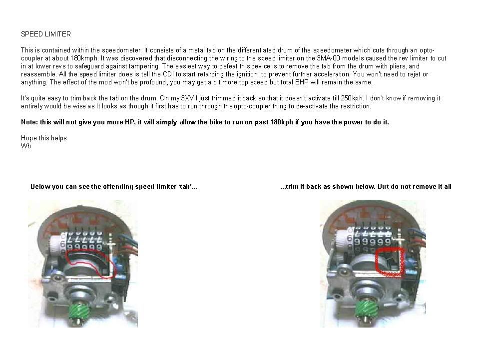

The Japanese part has a volume of electronics added to the speedo unit. On this unit it has a disk that turns with the speed indicator (needle). This disk has a large gap, so as it turns and the needle reaches 180 k a step in the disk comes in line with two electrodes (They look like Carbon blocks similar to brushes from an electric motor). Being the smart ass I am, I figure if the speedo didn't have the disc, but retained the electronics, the system would think the bike never went as fast as 180k :lol:
Now the story. Ok, ozzie speedo, Japanese electronics retained. After two weeks of waiting I took the bike for a hiding yesterday. Although the distances and frequency was not that great, but the bloody thing is still restricted... I think. The problem is it seems to go flat, probably start missing at about 6750 rpm.
Have I envoked another rev limiter, or is there a posibility there are fueling problems :?:

Hi Sarg, try this
honkdawillydahonk wrote:Dave,
Is the restrictor circuit connected to the speedo? I found that an import TRX will stop dead at 180KPH in top gear - unless you unplug the restrictor circuit; in which case it stops dead at around 6500-7000 revs in ALL gears!
See below for an explaination of how to get around the speed restrictor... (This is for a TZR250 3XV, but the principle is the same... The circuit MUST be plugged in for this to work)
The other way is to fit a 4UN Cdi as I have done.... Then you can fit an MPH speedo and leave the rectrictor circuit hanging in the breeze if you wish....

All seems logical. By doing what I did with the other speedo, attaching all the electronics from the old Janaese one, I thought the result would be the same, but maybe not. There could be something else "One cannot see" or understand.
Thanks so much for the trouble you went to. I got a quote for a 4un at $250 a little while ago. Too tight right now I guess & thought I could beat the bastard.
