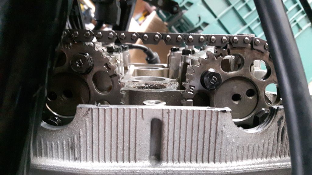

So, a week after having the bike into a mechanic to have the valve clearance checked and £350 bill... the bike is in pieces in my garage. Glaring error #1:
Top tip for anyone doing Valve Timing Chain timing... don't do it a; when you are tired/irritable b' under a self imposed timeline. Make notes, think about what you are going to do and take it easy, its actually quite simple, unless you are tired/irritable and working to a tight, self-imposed timeline! A couple of additional pointers I found useful, with the exhaust timing correct, I cable tied the chain to the sprocket so the chain couldn't slip. Second point was to think it through then mark a dot on the sprocket with a destination on the chain, so when everything was loose and apart I knew where to put the sprocket. Sounds simple enough [and it is] but I spent hours chasing my tale last night.
I can only assume that the mechanic got the timing chain on 'correctly' but didn't hand crank the engine [service manual states two full engine rotations then check timing marks again]. then by the time the chain tensioner kicked in it was all over the place... that or the guy is a total fuckwit.
With the timing chain in the correct place on BOTH cams, time for glaring error #2. I went through and checked the clearances again, the timing chain must have been 'one of those things' surely an independent professional mechanic can't have made two giant feck-ups.... #1 cylinder, middle inlet valve will 'just' get a 0.08mm feeler gauge through it... the other two will just about take a 0.10mm, not good on a 0.15mm - 0.20mm range.
I was going to put the whole thing back together and take it back to the guy to fix, but then if he managed to get it so far out the first time, whos to say it won't be worse when it comes back on round 2. I've put the Fireblade back on the insurance so I can have the TRX off the road for a while to fix it properly. I'd left the bike at the mechanics for a week and expected a proper job, what I got was a rush job the day before I came in to pick it up, so seals were 'made good' with paste sealant rather than replacing the gasket and no Cobba, he didn't replace the O-ring on the 90 degree pipe on the cylinder head, just a bit more goo. Overall, really unimpressed.
Whilst its this far apart, I might crack the cylinder head to check the valve seats, maybe even get the head gas flowed whilst its off; make it a bit of a winter project.
In short, thanks for those that gave advice and sorry for not believing it.

Faaarrrk, this sort of shit really grates my ginger
at least you didn't hit a valve and destroy the engine. As you're already in there do a once over and get her ready for Summer
