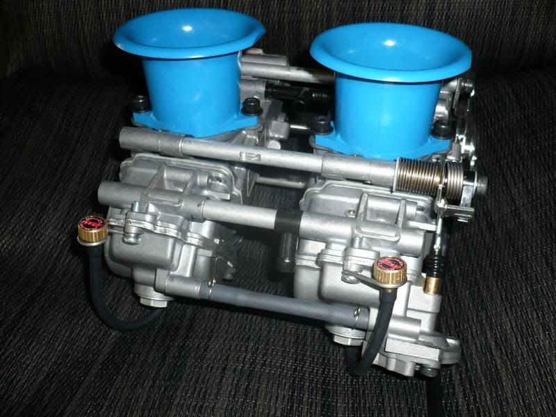

1. The new carbies are great except when it comes to getting going from stationary...I have to get the revs up to around 3K and then feed a little more throttle after the clutch bites. I could live with that if it wasn't for all the roadworks locally and stop/go signs. I'm thinking she's lean and needs more fuel screw/less air screw. Revs cleanly in neutral, runs fantastic everywhere else...just getting off the line is an issue.
2 Does any extended fuel screw for an FCR fit? Or does it have to be fcr41 specific?
cheers

by Dav » Thu Mar 29, 2012 5:56 am
Hey Mince, those R and D
flex jets don't fit the fcr41s...I found this out the hard way. In much the same way as you can't remove the fuel screw without taking the float bowl off the
flex jet won't fit thru the hole in the float bowl. A bugger cause I was looking forward to easy on-the-fly tuning.

by Dav » Thu Mar 29, 2012 8:52 am
I got a reply back from R & D themselves (rather than the ebay reseller)...they said the 3 bolt float bowl (which the 41s have) simply needs to be drilled out. I'm going for it

by Dav » Fri Mar 30, 2012 1:35 am
The hole was ovalised as it was cast rather than machined...varied b/w 5.3 and 6mm. I did a test drill on some scrap titanium and found a perfectly round 6mm hole is a nice clearance fit for the
jet/
flex jet. Went ahead and drilled the float holes out to 6mm and result! Off to the bike we go:
edit: I found better places to hang the screws than off the bowls. Now to tune

by Dav » Fri Mar 30, 2012 6:50 am
Hmm, well it certainly makes fooling with the bike a lot easier...although I haven't nailed the lack of power off idle issue. I did take notes and changed the fuel screw in half turn steps from 1/2 a turn out to 2.5 turns against the standard air screw setting and then changed the air screw against the standard pilot setting from 1/2 a trun to 2.5 turns. Interestingly the air screw had the most pronounced effect on idle speed (idled highest at 2.5 turns). The answer is in that matrix methinks. Enough for today. Next time around I'll remember to take a fan to the garage. Beer o'clock
