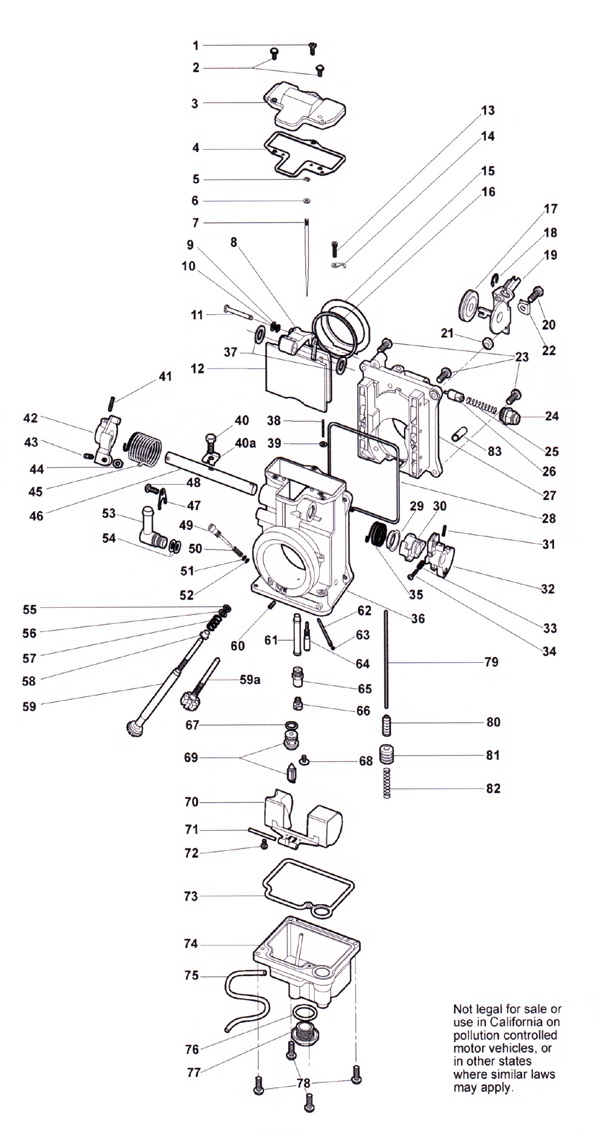

This may be more of interest, click on it to zoom the image:
http://www.sudco.com/Diagrams323728/expfcr.gif
Spend a little time there and you can ascertain the part numbers you require, and yes it seems all the FCR`s share alloy spacers, link tubes and spindles, varying lengths obviously to suit application. I actually split mine when I first got them, they got an ultrasonic clean before reassembly, setting up and fitting to the bike.
I set the slides with precision ground round pins and they were almost perfectly balanced when I did my first dyno run.
The pair of 39`s shown here have the cable quadrant inboard of the left carb, there are plenty of ways it can be done but I`m not sure how expensive it will all get. The plain alloy spacers and plastic fuel tubes (could be replaced with stainless tube) can all be turned up if you have a lathe handy, even the spindles can be made / machined up but unless you can do it all yourself folks time is expensive:
