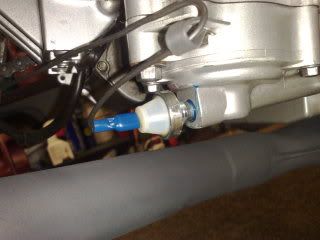

Most bike pressure switches are set at 5 psi, which is too low. The one that I fitted from http://www.speedograph-richfield.com/ht ... lines.html is 20 psi, and will warn you in advance of Impending failure. Most TRX's ruin big ends/ cylinder heads because of low oil levels.
Here is the cool Led I fitted which is real bright set at 20 psi.Image
I used a 1/8 npt tap (9MM DRILL BIT) to drill straight into the soft plug on the oil filter cover, which is directly after oil feed pump. Works a treat, and doesn't leak when a little thread seal is used.
