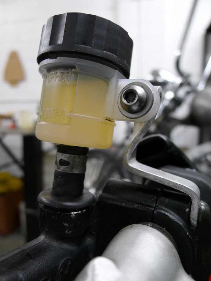

Brake reservoir conversion

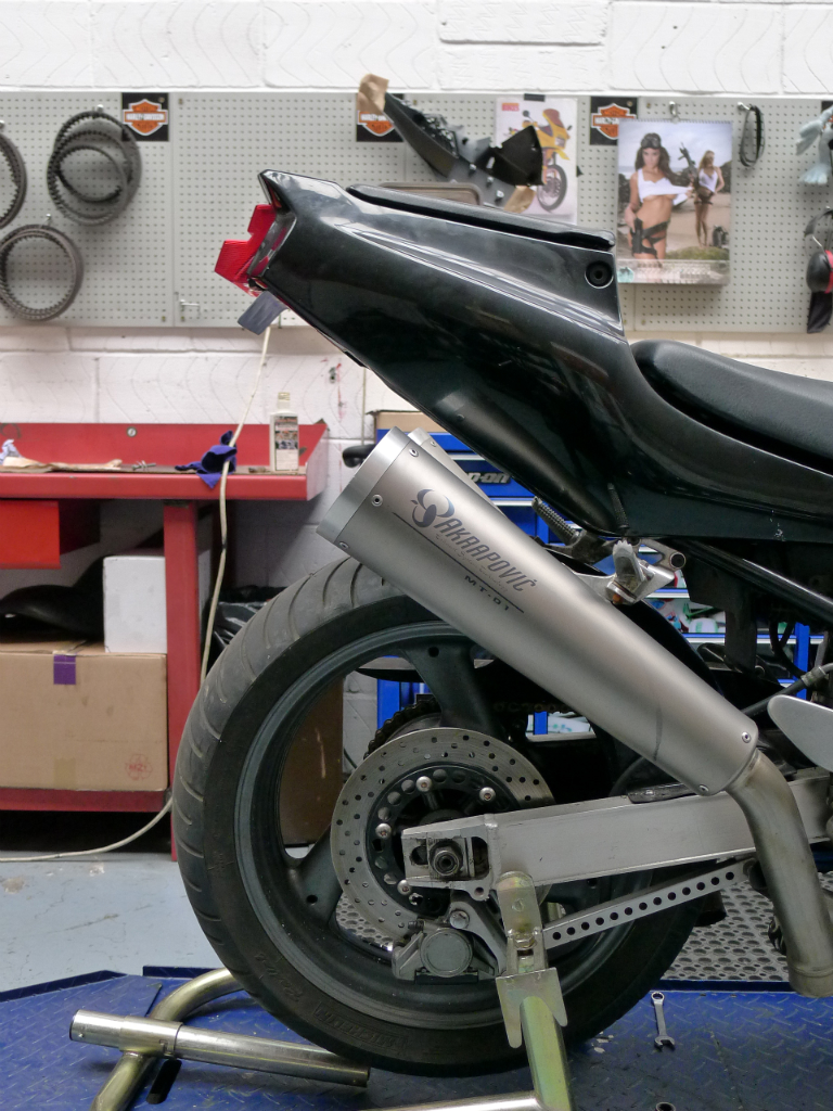

YZF750 rear light after many hours of cutting and glueing
the slip-on is a MT-01 Titanium Akrapovic and its just a mockup. Its not mine and its just for a visual.

Brake reservoire conversion?
Ist that the Original one You remounted wit a shorter hose?
As I am allos changing my TRX (to be posted) a need a smaller reservoir, as my speedometers will sit lower.
But a relocation coud also be an option.
B-art
Re: "Abandoned in North London"-The Rebuild Thread
Post by Mincehead » Thu Jan 20, 2011 11:55 pm
The reservoir can be mounted directly into the master cylinder as long as it`s a snug fitting, the stub that the hose from the resevoir would normally connect to is also a push fit in the master cylinder by the way. :wink:

B-art wrote:Nice
B-art
The reservoir I'm currently using is about half the size the original one and sits on top of the spout opposed to the original that was on the side, bolted to the top yoke.
This reservoir came off a 2009 Z750 rear brake.

"The reservoir I'm currently using is about half the size the original one and sits on top of the spout opposed to the original that was on the side, bolted to the top yoke.
This reservoir came off a 2009 Z750 rear brake."
Question...will this brake reservoire affect the braking in any way...feel or power?? Interested in doing something similar :wink:
Post by Mincehead » Sun Jan 23, 2011 5:51 am
No, the only effect will be at `bleeding` time, you just need to fill the resevoir more frequently.
If the resevoir has too small a volume of fluid there may be issues as the pads wear (as more fluid will be required to fill the lines and calipers etc), often folk will experience a little extra lever travel as pads wear down.
There is only pressure in the fluid between the master cylinder and the hoses, calipers and pistons when the brake lever is depressed, the fluid in the resevoir is at atmospheric pressure.
Some examples of the many types of resevoirs that can be found, the billet types with the clear windows to see the fluid level are especially nice:
http://www.carbonpartz.net/id93.html
Depending on the depth of your pockets there`s some real `exotica` out there:
http://bellissimoto.com/BrakeFluidResevoirs.html

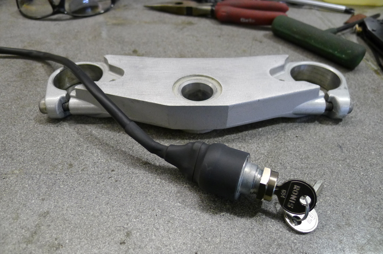

New ignition barrel:
Post by Mincehead » Tue Feb 08, 2011 11:52 pm
Ah yes to `clean-up` the top yoke. =D>
I`ve had the ignition boss milled off my billet R1 top yoke, I intend to fit a keyless system with a passive fob eventually but to get the bike mobile for the rally season am considering a hidden microswitch.

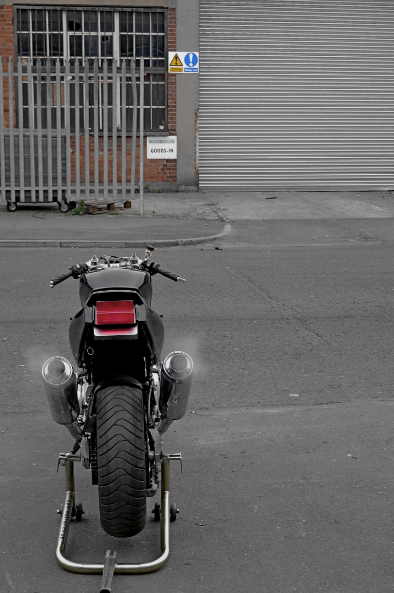

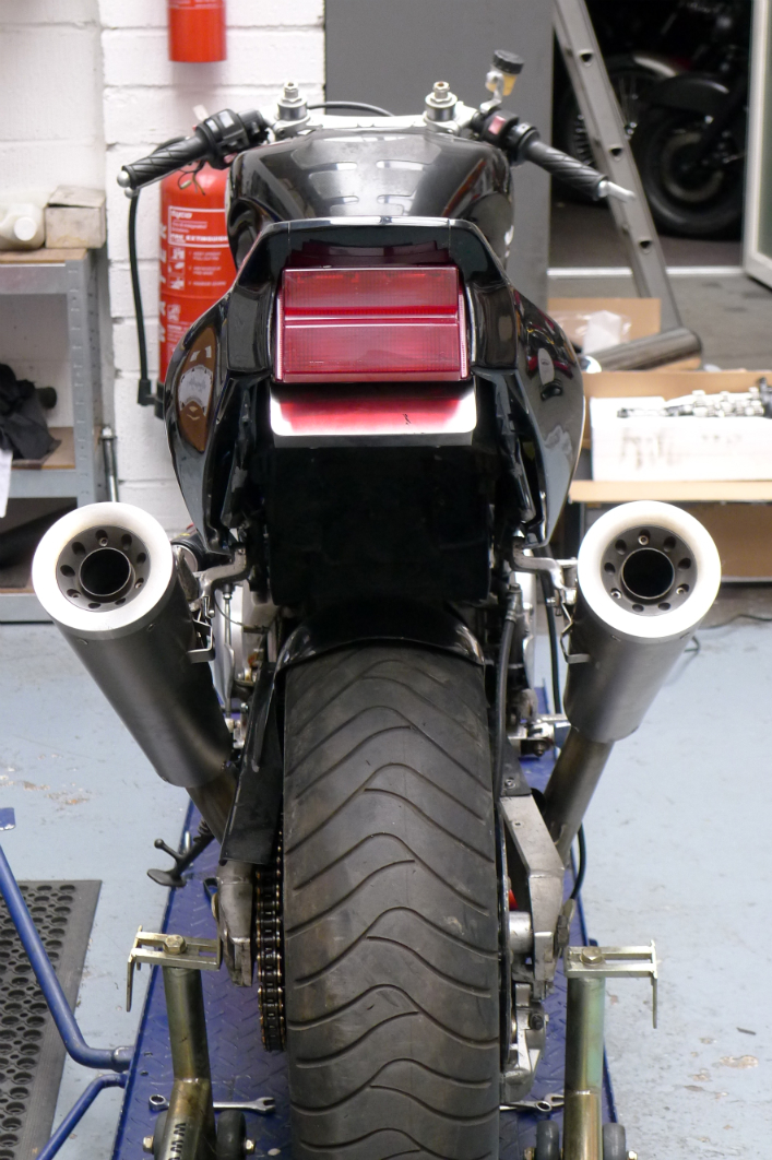

Nice Pic , bike from the back.
Looks almost B/W.

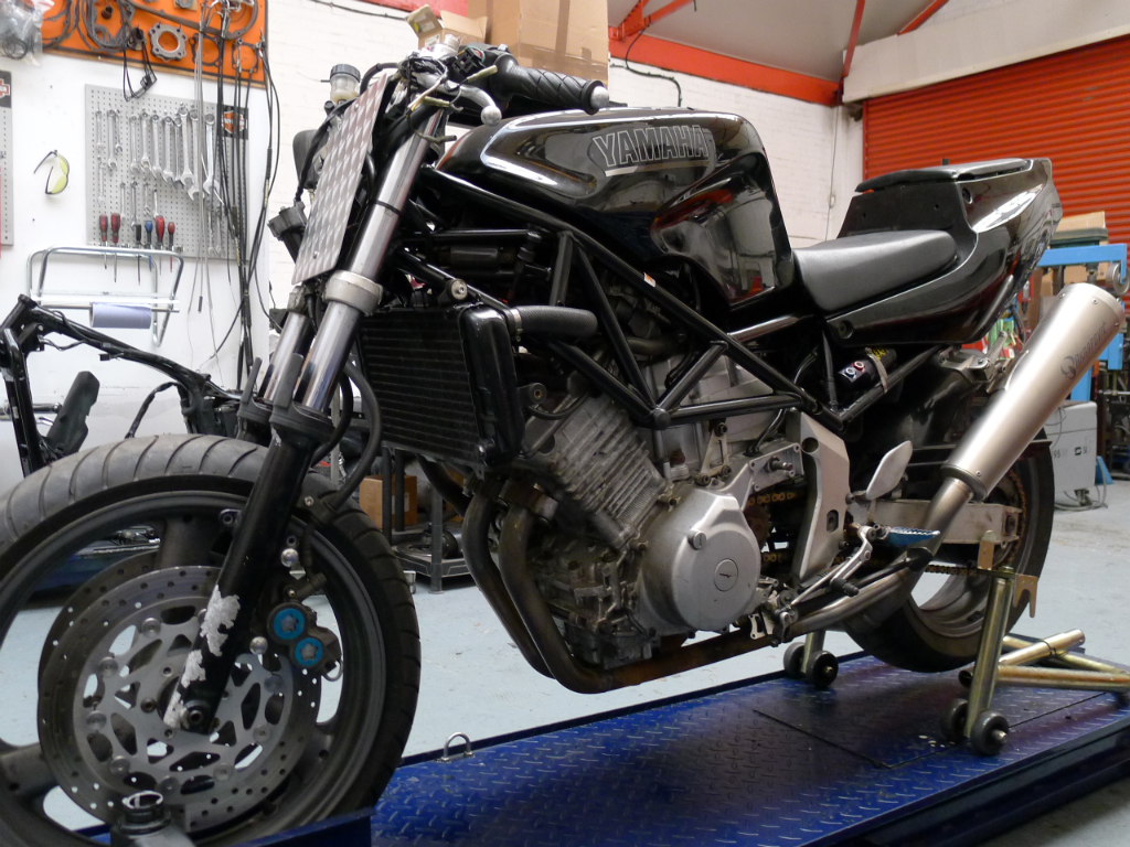

Thundercat forks with the stock TRX wheel. Needed an 8mm long spacer on one side and a washer on the other and it's good to go. The calipers had to be spaced in with a washer as well.
I've also got the stainless bends and I'm about to start the fabrication process on it.
More soon
